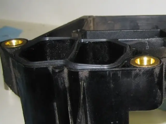

I just replaced my heads and was surprised that the upper intake manifold gaskets came in a set of 6 when there are only 3 that I see on the plastic manifold... Am I missing something? Assuming I'm not, if anyone sends me an email or IM I'd gladly mail these other 3 to you if you want them. (I'll edit this post or post again if they're claimed.)
Another Bill
Did you only open one side of the intake manifold? A 6 cylinder has 6 openings for the air intake.
For the OHV, the upper intake to lower intake only has 3 gaskets because the each gasket is for 2 intake ports.
