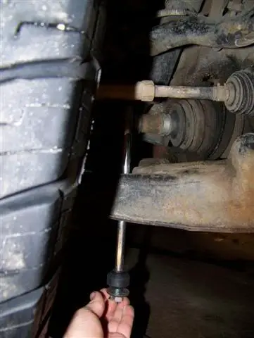

Well it was time to change my anti-sway bar links so I brought a camera. This is what I found one day after hearing loud clunks every time I hit uneven ground:
As much as I dont like NAPA, I'm a sucker and keep going back to them. The job would have neen made easier if the bolts were 1 or 2 MM longer to help the nuts grab the thread. The kit comes with both sides (indevidually packaged per side) loosely in a bag, but here is what the stackup should look like:
If your old link is broken, removal could be as simple as pulling down (or up) on the remaining bit, or else some release-all and a 15MM socket for the bottom and 16MM socket for the top will do the job. When I removed the non broken one, the nut was on the bottom and the bolt was passed down from the top, so because of clearance issues I lifted the truck a bit from the front crossmember to be able to pull the bolt out.
*note: I realize that safety wise I did the job wrong, I installed it from the bottom up. The reason for this is in the case of a nut letting go, the bolt will not simply drop out and disconnect the anti sway bar, so I may end up re-installing them later in the propor fashion, but you can still use the pics as reference, just start from the top instead of bottom.
start the stackup with a washer and bushing (they bushing "cups into the washer and the smallest part of the bushing should fit into the holes on the arm and bar, so it's hard to get it wrong)and pass it through the first hole
Then continue with a bushing and washer
This is where you would add the copper coloured tube spacer. The next half is identical to the first portion. To be able to get the nut started, you then have to drop the truck back down and tighten away. I dont know about a torque because you dont want to wreck the bushings, so I just put it tight with about 3-4 threads showing. The new bolt and nut were 11/16

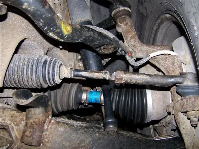

omg this helps so much I bought the new end links and they are too short. about to freak out. took them back to the store they said you have to jack the control arm itsself up to make up the difference. does this sound right? after looking back online these are the longest ones they sell. .5 inches too short!!
Many have put the end link bolt heads on the bottom and used a floor or bottle jack to start the threads.
Do not over torque, about 15-20 ft/lbs for polyurethane, or until you can barely turn the center sleeves by hand.
liquid wrench penetrating oil worked well for mine idk how stuck it was before that though
for me the hardest part is getting the old ones off (broken or not). i found the saws-all worked pretty well. what a dumb-ass design Ford has. i used the Moog problem solver end-links with the blue colored bushings. as long as you take both old link bolts out, the sway bar will just swing up & down. i had no problem getting the nuts on, but if you do (like other's have said) put the bolt in from the bottom and jack up the control arm as necessary. i found i had to re-tighten the nuts after a few months as they started making noise. no problems since.
STILL the best cheap suspension mod I've ever done. The Moog K7275 end links with soft blue thermoplastic rubber bushings are known for blowing out, or pulling through the cupped washers. Replacing them with the 7/16" I.D. ES poly bushings made them almost bulletproof and they will probably never fail. Can also be tightened without deformation.
