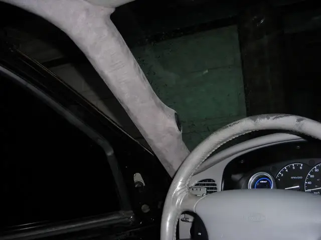

depending on how serious you want to get about your sound. Mounting angle and position of the tweeter is crucial. As is sealing the door panel as well as possible to create an enclosure for your mid (providng you dont have kick panels). Some component sets are designed to have the tweeter as close to the mid as possible, some strongly suggest as much seperation as possible.
In my truck I put the 6.5 mid in the door and glassed the tweeters into the A pillars. And let me tell you it sounds absolutely delicious!

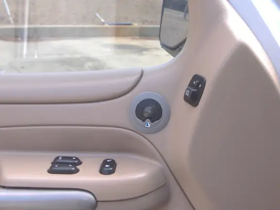

i think that im just gonna go with the 6.5 component setup. The work will all be done on my own like i did to every car that i owned. I am extremelly knowledgable about audio setups, and the placement of speakers and what-not.
But still my question has not been answered yet. I am looking for pods for the tweeter that go either on the door, or replace the a-pillar, or something that goes on top of the dash adjacent to the a-pillar.

Take a look at this thread it may give you some ideas: http://www.explorerforum.com/forums/...ht=boston+sl60

Heres all I did to put 6.5s in my 2005. Level of difficulty 2. Just traced and then cut the little notch out to let the panel mount back on.
__________________
Currently "Livin Loud"
Last edited by koolwhipman; 03-08-2007 at 06:46 PM. Reason: Thats a eD 6000v.2 btw, and the tweet is now mounted in it, co-ax style, without clearance probs.
