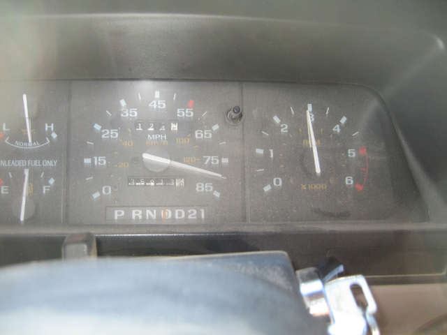

Yeah, 1st gens have the P R N OD D 2 1.
FROADER is online now   Reply With Quote
Old 11-22-2007, 01:57 PM   #39
Donner
Natomas/Irvine
01 Sp 03 XLT 4x4s, Scion
Join Date: Oct 2007
Posts: 6,844
Vehicle Specs
Ford took that option away...
Quote:
Wow! You took a pic driving at 80? and w/a cell phone? Very brave!
So now OD is recommended, but it wasn't before... that's confusing.
