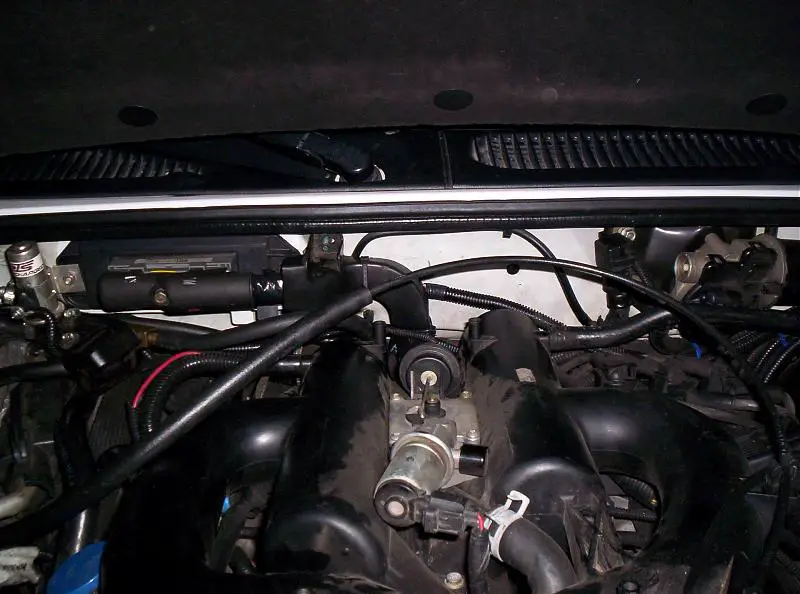

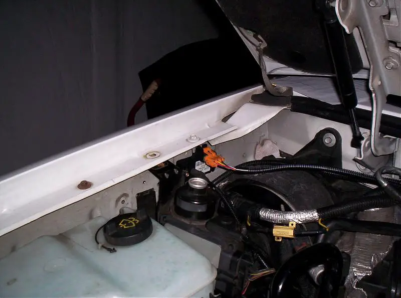

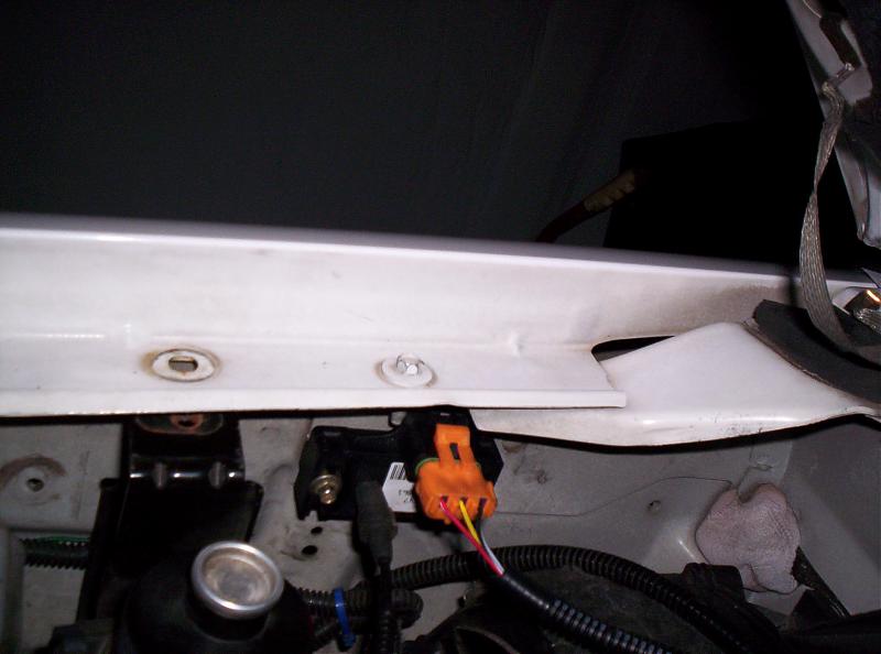

Here are the pics of the MAP sensor mounting position, the cruise module is only in mock up at this moment (not bolted to the fender)for representational purposes. Also the manifold cover is removed till I get my air intake and fan/shroud assy back on. I am currently contemplating a e-fan swap so this is the reasoning behind me not having this assembled yet. The bottom pic is of the computer showing the finished product (wiring and mounting of the STS solenoid). It is slowly coming together. I am on the downhill side of things!

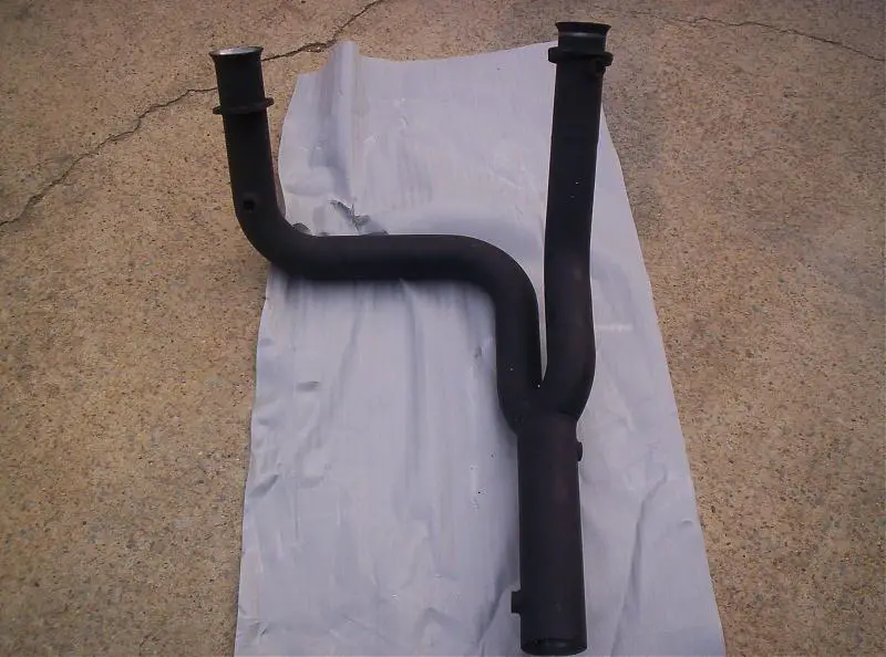

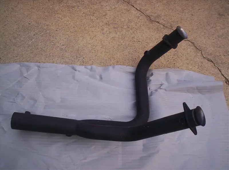

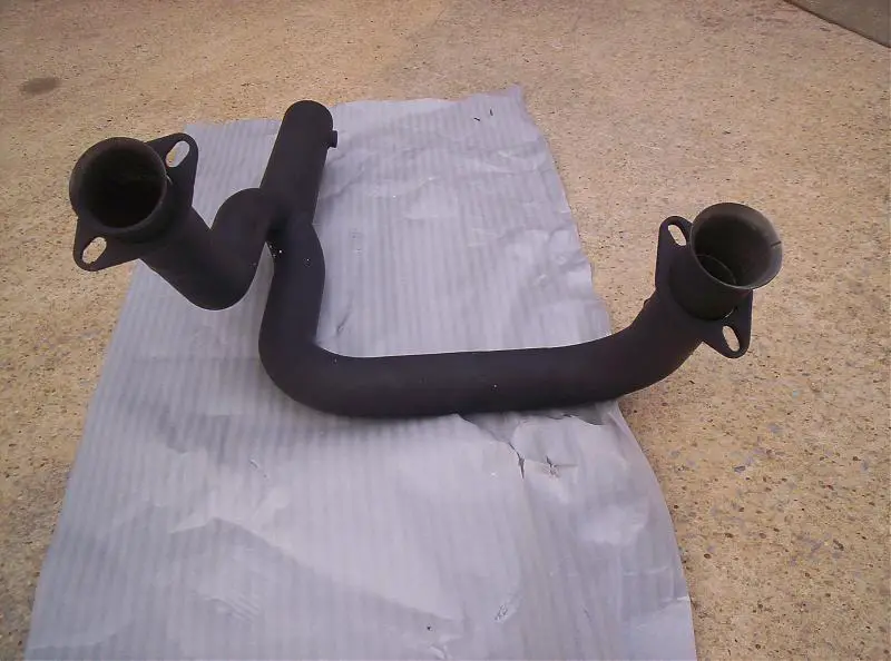

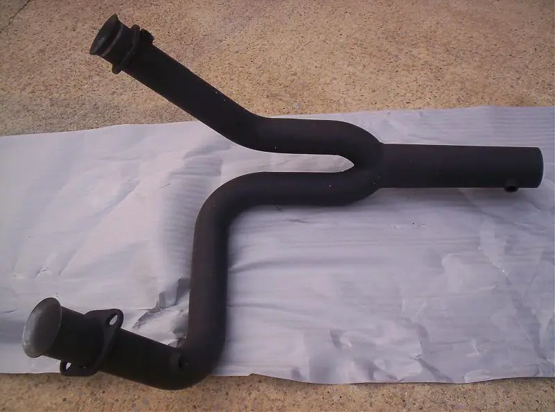

Y-pipe
Yesterday my Y-pipe came in. This particualar pipe is supposed to be a prototype. It is very far from a prototype. The quality of bends,welds,flanges and bungs are already there. I was really impressed immediately after unpackaging the product. Eventually I will purchase a stainless version as I am currently prototyping this particular model. For information regarding this pipe contact Jakee on the availability. Thanks again,Jakee- really nice product!!!!!!

There's room for improvement and we've already figured out what changes we're going to make for a better pipe. We'll include a 3" ball for future pipes.
Back to the tranny. How hard do you think it's going to be to tune this tranny?

Got my exhaust finished. Currently I don't have a muffler at this moment so the only thing that I have is the turbo muffling it. It is too loud. Got the tranny software installed it has taken gear (on the jackstands) and everything seems ok at this point. I believe I should be good for a short drive sunday. I will post up pics later.-j

James- Oh this brings back so many memories. I dealt with pretty much the exact same issues that you just did when I did my standalone swap.
Jakee- That is one quality piece you sent James there. Far from prototype just like James said.

Tuning(shift firmness,shift scheduling,etc) the trans isn't going to be the problem. Pretty cut and dry. But getting the thing to shift properly is(knowing when to energize solenoids,which solenoids to use,etc-could be the problem.). This trans hasn't been coupled to a standalone as of yet,or that I am aware of. So yes this is unchartered territory. The guys at PCS (Russ & Dan) have been incredible and we are making excellent progress. Worked on the trans tuning yesterday around 6hours(thanks Russ!) and did drive down the street. I will hopefully finish the initial setup this evening and then I can start tuning the trans.
The exhaust is very loud and the turbo seems to spool very easily now with the new y-pipe. I will post pics when I get the first chance.
