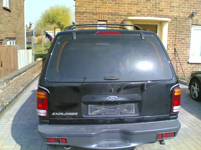

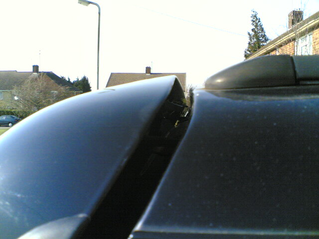

I've changed my hatch from a 97 to a 99 and I've got a major problem...
There's a massive gap, and it won't line up.
I've used the 99 hinges, 99 struts and the hatch, but it won't sit straight, as a result I've managed to bend all the top of the lid...
does anyone have any ideas how I can sort this out? I've even tried changing to the 97 hinges and this makes no difference at all...

the bolts that go into the hatch control the up and down that seem to be giving you the issue
Removing the struts make the adjustments easier. I some times also remove the latches.
Good luck and let me know if you need any further help.

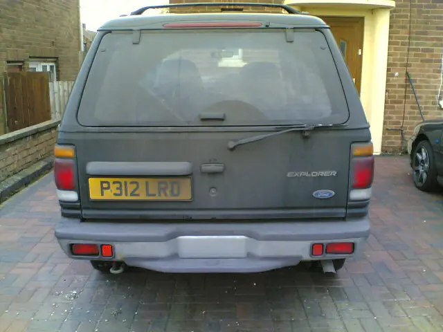

it's booked into fords tomorrow for them to have a bash... it's annoying me
Attached are before and after shots

I've found out why it doesn't fit!!! it's cos I bent the hinge mounts on the underside of the door when I first opened it and it foulded..
So I've got to get a new door

I recall having a hard time refitting my 93 hatch, after removing it to change left quarter panel. There is very very little adjustment, I had to hammer the top edge downward(bent it to set flush), and fill the ripples, etc.
Sorry to hear of the bent hatch, are you sure that it cannot be bent back inward, the mounting structure is very strong. I'd bet that a good body man could make it fit. I know how heavy the hatch is, that was the hard part. I had to test fit my hatch many times until I was happy with it. Good luck,
