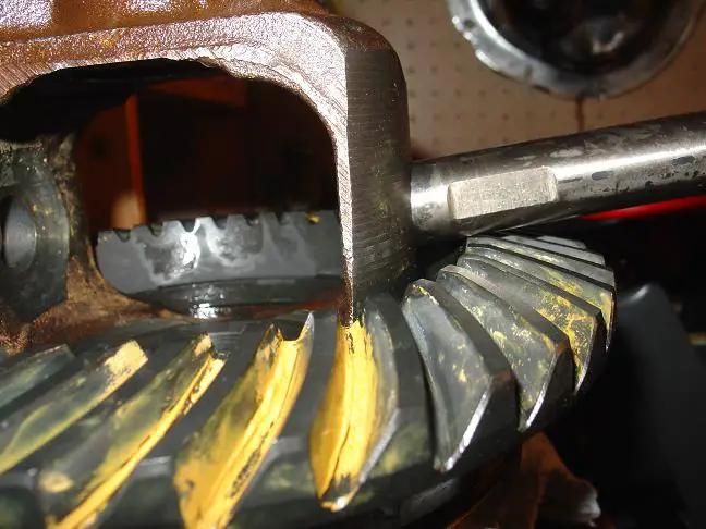

Alrighty, we used a big dremel / die grinder from work, I THINK it`s a 25,000 rpm unit, but could be 28,000 I just can`t recall.
We used a flapper wheel on it starting with 60 grit, then 80 grit (we coulda stuck with 60 but we had a smaller 80, which just fit better).
Anyway the dremel with flapper allows you to go slow and grind with minimum heat build-up. We took most off one tooth with a smidgeon either side, hit the edges with some emory cloth. Then cleaned all the components real well before putting it all back together. Ideally we would have done this first, but we only found out it had to be done at the last minute. We had covered the bearings with latex gloves in case you're wonderin what that green thing is.
-here are the pics...

I dunno, the Jeep guys seemed to say it was alright, we even asked him about evening it up on the other side for balance and he said don`t bother. I don`t know the guy or anything, so I can`t vouch for him, but the amount of material we took off was so minimal. I can`t see it whining, plus the material taken was not into the contact area of the pinion gear as indicated by the gear paste.
whine in general is attributed to the ring and pinion not meshing properly. So you'll be fine as long as you didnt grind into the two gears' contact area.
