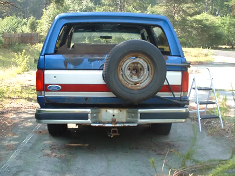

rear bumper spare tire
Check out this page scroll down to the bottom and you can see my Explorer with the rear spare tire mount.
