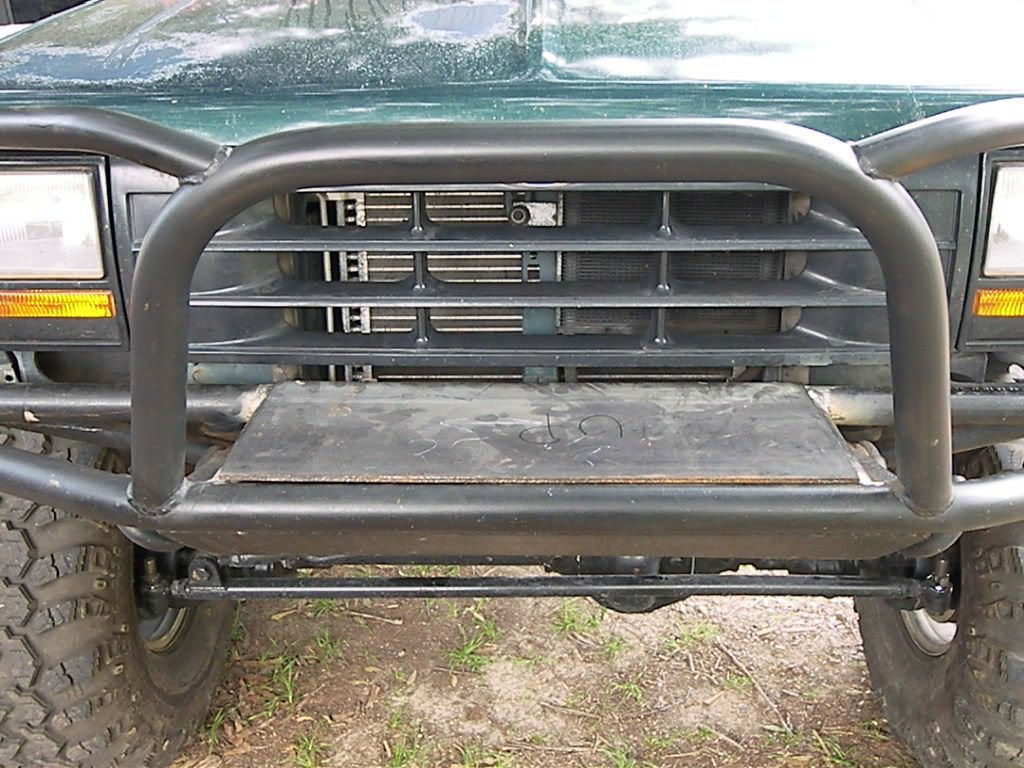

Started my winch mount....
had to add few pieces to my front bumper to fit a winch....it should be here tues. or wed. and i'll finish it...
its bolted with 4 factory bumper bolts and welded to the frame at 8 different points.... it "should" hold.....
added the rear bar and the 3 in the center..... also made two small pieces that connects the rear bar to the frame next the the outter bars....
it'll all be tied together with a 1/4" plate welded all around ..... i'll mount the center tube directly under the winch...the bolts will be on either side... i'll cut a slot in the plate and weld the plate to the center tube....
i'll add a fairlead mount also...

all done.... the primer is drying overnight and I'll shoot a shiny coat or two of black in the AM..... should have it all mounted by tomorrow a/noon...

yup... its all here....

stick a fork in her..... she's done...

yup... its an atlas... I got the 9500 for 349... should have gotten the 12K for 449, but I didnt see it... has all the same exact specs as a T-max... I've heard its a rebadged T-max...
I can only take credit for the winch mount... the bumpers were done by svande.... this is his old rig....
here's more pics...
