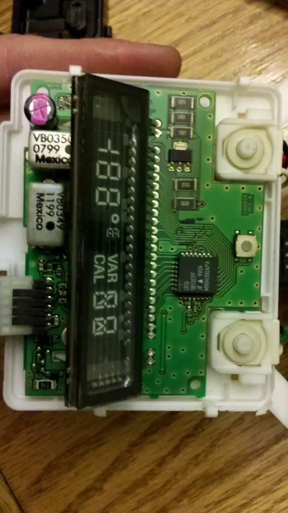

My 2004 Sport Trac developed this problem. I couldn't see any issues with the solder joints. However, with the board plugged in I could get the display to work by slightly pressing on the 510 resistors, so I know the solder joints must be cracked.
I don't have the tools to solder the joints right now, so I dreamed up a temporary solution. Using a tootsie roll wrapper, I folded the paper in half 4 or 5 times and taped it to the cover, positioning it just so, so that when the unit is assembled, the wrapper presses on the resistors just enough to and complete the connection. So far this fix is working.
I'm off to Radio Shack to purchase a soldering iron to make a permanent repair, but I just may see how long this temporary fix will work.
