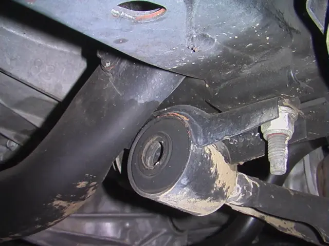

Welcome! Looking for the locations to lubricate...

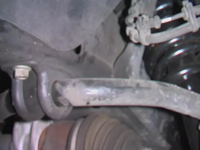

Front end...
Corrections please, if these are not the right areas to lube: The round objects next to the bolts.
