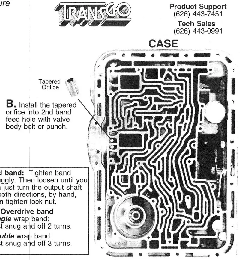

ok, installed new EPC and TCC solenoids. Same problem. I did inspect the wiring harness and it looks great.
more things that I noticed today, When it first starts, putting the transmission into drive will put enough drag to stall the engine, but only when cold. Also the transmission and torque converter work well in 1st and 2nd gear, then in 3 and 4 the torque converter slips until it flags the error code, then the torque converter locks up all the time unless the vehicle is stopped.
Two things come to mind that may be the cause of it, but I need more expert advice.
1. When I had the valve body apart, there may be a chance that I got the "converter relief" and "EPC limit" springs and valves backwards when installing the valve body plate. Are these the same? What exactly do they do?
2. I installed the 'tapered orifice' in step B of the transgo kit. What does this do? Could this be causing the band to not fully engage?

Any idea what the orifice that I had to install for the shift kit does? I'm inclined to pull it out and see what difference that makes. I've not seen any mention of this with any of the stickies here.

Could you show us a picture of step B, and write what the kit says about it in the instruction sheet?

here's a scan of the transgo instructions. It seems that this restricts fluid flow to the intermediate band, but I have no clue why. What do others think?

I pulled everything apart, pulled out the extra stiff spring, that made a difference in shifting. I also inspected everything, cleaned it all again, verified all parts I touched are in the right spot...
