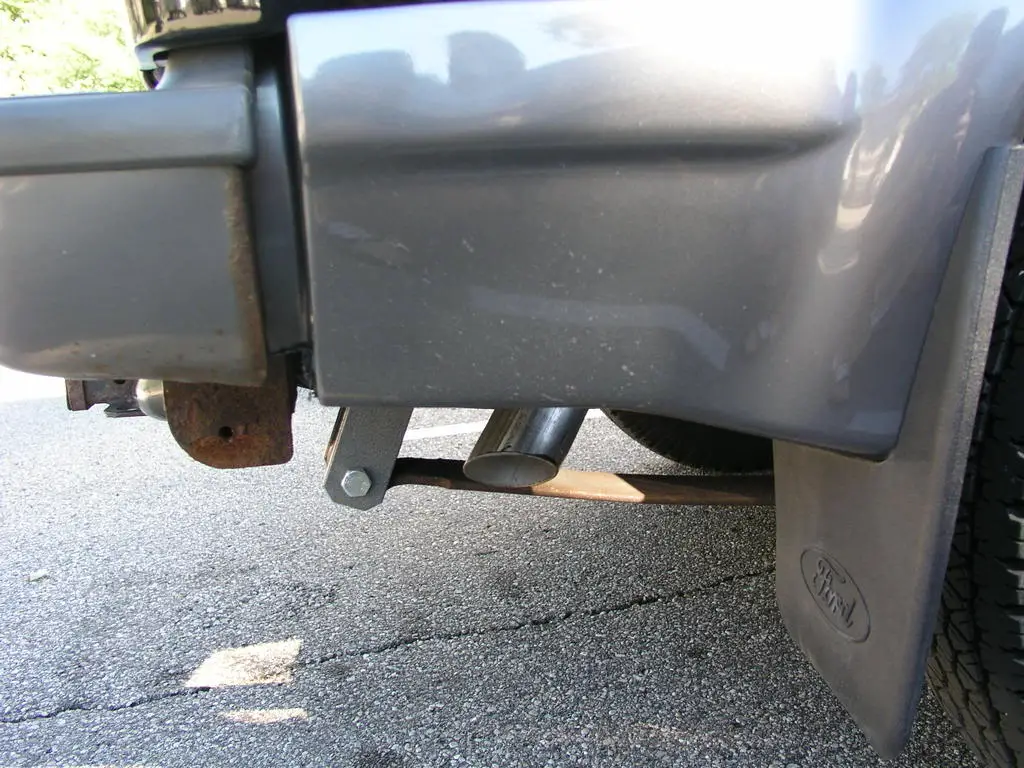

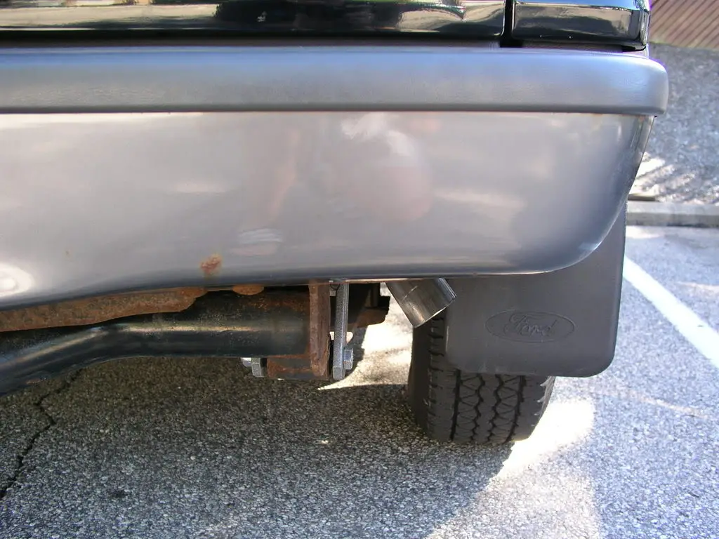

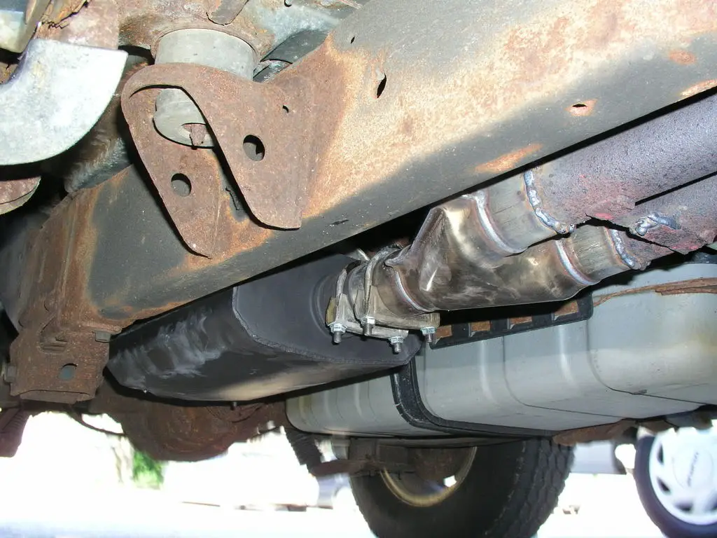

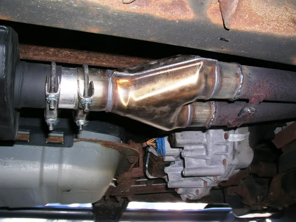

I am currently running an offroad Y pipe which was custom made. This means I have 2.5" piping from the manifolds that combine in to a Y pipe then go out to the muffler. If you have stock piping, Holley only makes one muffler that would work for you if you went MaxFlow. That would be this one
http://www.holley.com/21810HKR.asp
Now to run that muffler, you HAVE to run dual outlets. I didnt want dual outlets, I wanted a single 2.5" pipe running out the back. The reason for this is I did have dual outlets once and I lost low end power from it. Now, if you want to run this muffler without duals, you will need to convert your stock config so it will go into 1 pipe then into a muffler. This is where the Y pipe comes in. You would cut off the stock muffler, weld in the Y pipe, then run a single pipe from the Y pipe to the muffler.
The cherry bomb would be your cheapest bet, as they make a muffler that will fit your needs perfectly if you're running a stock setup without big mods like I did
If you want to run all stock pipe and just replace the muffler, the Vortex muffler you would want is the 88106
If you want to keep the stock pipes but replace the muffler then the tail pipe with a 2.5", which is optimum for our motors, you would get the 88107. This will allow the dual 2.25" stock pipes to enter the muffler, then run a 2.5" to the rear and you're set.
The main reason I had a Y pipe put in is because I always wanted an original 40 flowmaster but they didnt make dual inlet configs. Also- please make sure you know I picked my muffler due to the charts above. I wanted to maximize power and MPG while not having drone and getting loud when I step on it. The maxflo fit that; however, you will need a Y pipe to get the most out of it to install it. As for a video, I need to find someone with a cam to borrow
