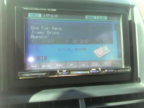

Mark - My Alpine HU does not have an mp3 jack, but why would I need that when I have this?
My ipod is in the glove box, I have not seen it in months. You might think its lame, but I don't. :)
You misread Mark's comment
wharriso, I don't think Mark meant to call your setup lame. Moreso, he meant that if your setup is ONLY Ipod compatible, then that would be lame because you would not be able to use a non-Ipod mp3 player with your system.
Again, that would squash your plans to try and use Rhapsody To Go service with a non-Ipod mp3 player, because then you wouldn't be able to use it with your present setup, BEACUSE YOU DON'T HAVE AN MP3 JACK ON YOUR UNIT.
Sounds like your setup is for Ipod only (alot out there) because I assume your system allows you to control the Ipod through the stereo and like you stated, you can stash your Ipod out of the way because of these nice features. A lot of systems allow for Ipod control because the Ipod is the most common MP3/DAP in the world!
