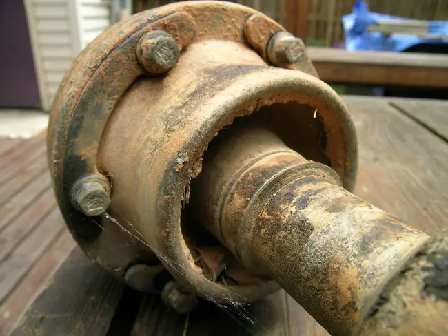

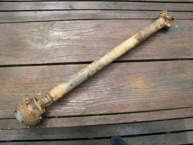

I've re-read your last post a few times now and it sounds like you actually pulled the drive shaft apart where you're not supposed to.
Your driveshaft, as a whole, should look like the set of images below.
It should hold itself together even if you hold it vertically on either end
It sounds like you took the driveshaft apart at the rubber boot -- the "CV" joint -- which is pictured in the third/bottom image.

Thats all you should have to do to remove the driveshaft:
- unbolt the 6 bolts at the CV joint
- unbolt the 4 bolts (on the U-joint's metal strap) at the other end of the driveshaft (on the front differential's yoke)
In the picture above, the 6 bolts near the CV are on the driveshaft only because I didn't want to lose them. But they do slide right out and the entire driveshaft should hold itself together without those 6 bolts.
But if you did take apart the CV, then I think you need to either get a new/used driveshaft, or get that one rebuilt by a shop.

I'm curious as to what is inside of that dome shaped part (picture 2) that interfaces with the transfer case? A bearing I suspect. I have a loud click coming intermittently from this very part. Can I guy just replace this part? ... the bearing with in? ... or does the whole drive shaft assembly need to be replaced? Please and thank you for any insights you may have.

The interface at the transfer case is exactly the negative/opposite of that dome shaped part. Pictures in this post:

Thank you for the quick reply. What I'd really like to know is what is the name of that Dome-shaped part in picture 2 and can it be replaced independent of the front drive shaft? The (bad) clicking noise I'm hearing seems to be coming from this part (hopefully the transfer case is okay). I'm wondering if there is a bearing inside a person can get to and replace, is it best to replace the whole part (whatever it is called) or should a guy replace the whole drive shaft assembly shown in picture 1. Hopefully, this makes sense and someone can help me with insights and terminology as I begin my search for replacement parts. Please and Thank You for the help.
msw is offline   Reply With Quote

Oh, Okay so this is the CV joint. Does it make sense that this would make a loud click... almost a metallic snap sound when bad. This doesn't happen on every wheel rotation but it happens frequently and seems to happen at the same point as I rotate the front tire. Many thanks for the info.

As posted, that part is the "CV" or constant velocity joint, which can be rebuilt. However, considering the price of the rebuild kit, the tools you need, and the time, most people will probably opt to replace the entire driveshaft as a new driveshaft will run between $200-$300.
