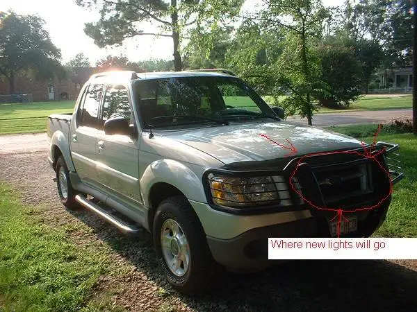

I have an 01 sport trac. I just bought my ST a couple of months ago but it came with no fog lights in the bottom bumper but did come with a brush guard. My question is...is it possible to use those connections to wire in a set of custom brushguard fog lights so that I can use the exsisting button for the lights in the cab...Here is a view of my ST to help explain what I want done. Any help with this will be greatly welcomed.
Thanks
Dave

I want to say thanks for the quick replies, but also I think my post needs some further clarifcations. What I'm wanting to do is take the exsisting wiring for the factory fog lights that are no longer there and use them to wire in custom fog lights on my brush guard that will tie in to the factory button on the dash. Sounds good in theory but will it actually work?
