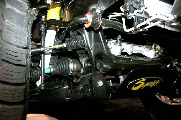

They show the Superlift logo, but not a clear pic of the skid plate itself. If it's the plate that comes with the Superlift 4" lift kit, then it should be OK for most use (far better than nothing), but not as thick as you would want for serious rock crawling.

does that skid plate just mount to the ifs to the frame horns or what? im interested...
i ave the superlift kit and skid plate, it bolts to the crossmembers
no they just bolt up with 4 bolts, 2 on the front crossmember and 2 to the rear crossmember and the the front of the skit plate just has a 45 degree angle that doesnt attach to anything. i think all it does is deflect rocks from damaging the crossmembers does nothing for the radiator area. i know they make another skid plate and that one im not sure how that one attaches
