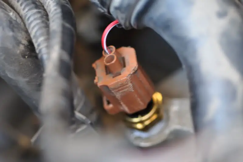

I have a 98 4.0 OHV Ranger XLT 4X4.
My temp gauge needle hardly moves until I shut off the motor then it moves to midway between the C &H and then gradually drops back to cold.
From reading similar posts from other members I think I’ve narrowed the cause down to the temp sensor or the temp sending unit.
It looks as if both are located on either side of the thermostat housing as in the above photo. Is it best to replace both just to make sure?

in the picture supplied, it appears that the gauge sending unit is to the left of the tstat. anyway, it should be the one with only one wire. the coolant temp sensor appears to be to the right of the tstat in the photo. another way to tell which is which, once you take it out, is that the coolant temp sensor has a pointed bottom and the gauge sensor is flat. plan on spilling a little antifreeze (not much if you're quick), don't put too much goo or teflon tape on the sending unit or it can't make a ground connection, and (words to live by) don't overtighten.

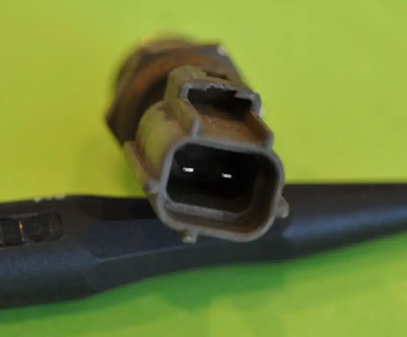

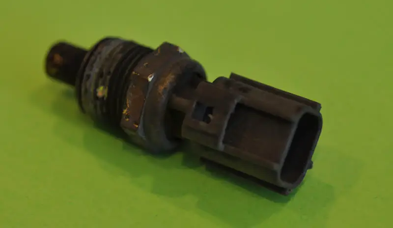

This is what I have the same layout as the above photo. But on mine the unit on the left of the thermostat has two pins but only one red/white wire coming out. The unit on the right of the thermostat also has a socket on it with wires coming out of it.
When I grounded the red/white wire the gauge went to full hot so Im assuming it is connected to the sender unit.
Here are a couple of views of the one I removed its listed as a switch in NAPA auto parts catalogue.
