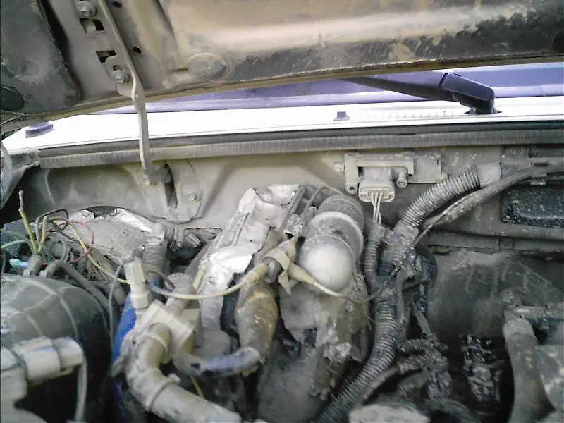

Ok i plugged it as you said but look on this pic theres a remaining hose unplugged ...what is it used for??? Sorry to bother you but thats a real mess there. The hose plogged on the left with plastic protector arond it is from bimetal sensor ..is it ok or i should use the other one under it?? A scheme would be really useful lol.

Yea DevilBoy is in the right track. The Corrugated line coming from the air box is supposed to go to one of lines on top of the coil and the other is for the FPR and the line coming from the under the heater hoses in front of the a/c box is supposed to go the t-fitting or the bi-metal you have there
Ok so the everything is ok except the remainng hose. Can you tell what is the use of the two small hose that are plugged together just next to the primary coil wire?? And finally do i need to remove the coil pac to reinstaller the FPR hose?
Not sure about the two that are connected together, but I think they might run back to the air box as well. There are two hoses connected to it. You shouldn't have to remove the coil pack to install the FPR hose, but I believe it is supposed to be routed under it, and it's a pretty tight squeeze to get your hand in there and connect it, but I have done it many times.

As you can see the corrugated hose come from the bimetal sensor or the air box and it plug on the left of the T.The other corrugated under the T and the right to vacuum reservoir. The hose that is sticked to the firewall is plugged directly on intake vacuum fittins and go down with a small curve to the FPR. Now did i made that corectly?? :P

Ooh i see that cybergasm your line sticked to the firewall go on the T...i made a mistake i think...or anyway the vacuum come from all the same place so it dont mather??
It shouldn't matter, because like you say, the vacuum should all be the same, but the the one attached to the firewall should go to the T, and the one that's attached in it's place on the T should go to the FPR.
Edit: In the picture I sent you, you won't be able to see the line to the FPR, because it is routed under the coil pack right on top of the lower intake manifold.
Ok i made a mistake then because i changed my valve cover gaskets and it must have been when i replugged the hose and reinstaleld the coil pack because the one on the T it was a real **** to try plug it on the FPR.
