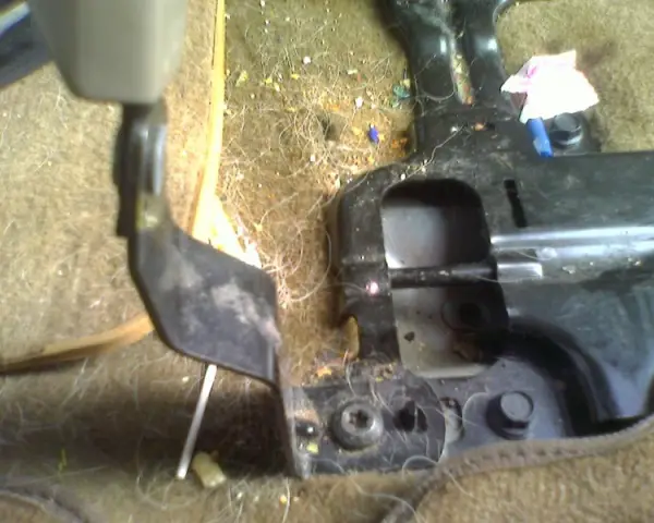

Curtis is close.
3-need seatbelt braket for 2nd row - see pics.
5-Seatbelt bolts to floor - see fuzzy pic, its bolted to floor.
