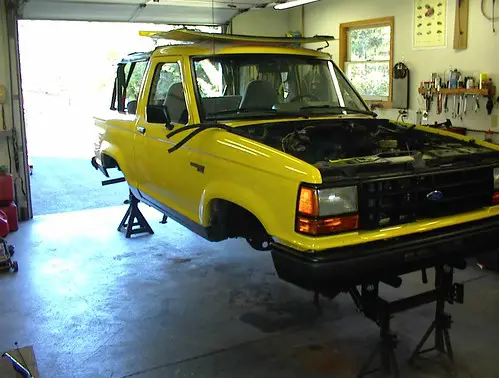

'90 BII chop top with Ranger bed rails and tailgate. In a few months I'll be swapping in a 4.0/A4LD/D35/8.8 from an Explorer.
More photos here... http://flickr.com/photos/9970648@N06...7600761070252/

It's looks like a squished ranger. I love it!

wow, i was thinking of doing this to my explorer.
Nice to see how it would turn out if i followed through on the idea.
really well done.
im impressed.

heck yes more pictures please!
Looks nicely executed

Wow, that looks awesome! I like the rear cover!
Can we get some close ups on the cutting?
Thanks

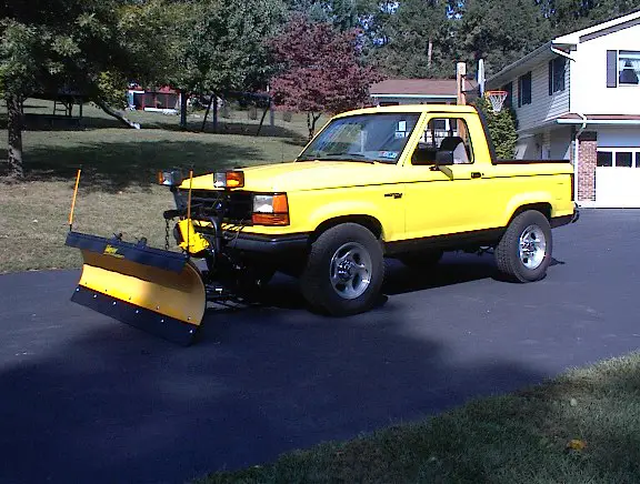

I've been kind of busy and I didn't really take any pictures of the conversion but...
- the 4.0 is in
- the manual 1354 is in
- front d35 in with Warn hubs
- front Explorer coils
- rear 8.8
- rear Explore/BroncoII leaves
Sits about 3/4 higher than before. Rides a little better. The extra power is real nice but I'd seriously consider going with a 5.0 and maybe a 5 speed if I had to do it again. The 4.0 was just to easy and cheap to pass up. With buying, selling some parts, and scrapping 3 first generation Explorers in the last year my total out of pocket is probably about $250, mostly for new belts/hoses/gaskets/etc.

I know this is an old thread but the photos provide the best 'how to' that I've found for doing a BII chop. Thanks to the OP for sharing.

I actually sold the chopped BII a few years ago and built this Ranger on a two door Explorer chassis. http://www.flickr.com/photos/9970648...7623357391357/
My daughter and now son drive it in high school. I have an idea for a full chop on a BII with a removable pickup cab, maybe some day I'll get around to it. Currently working on a flat fender jeep.
