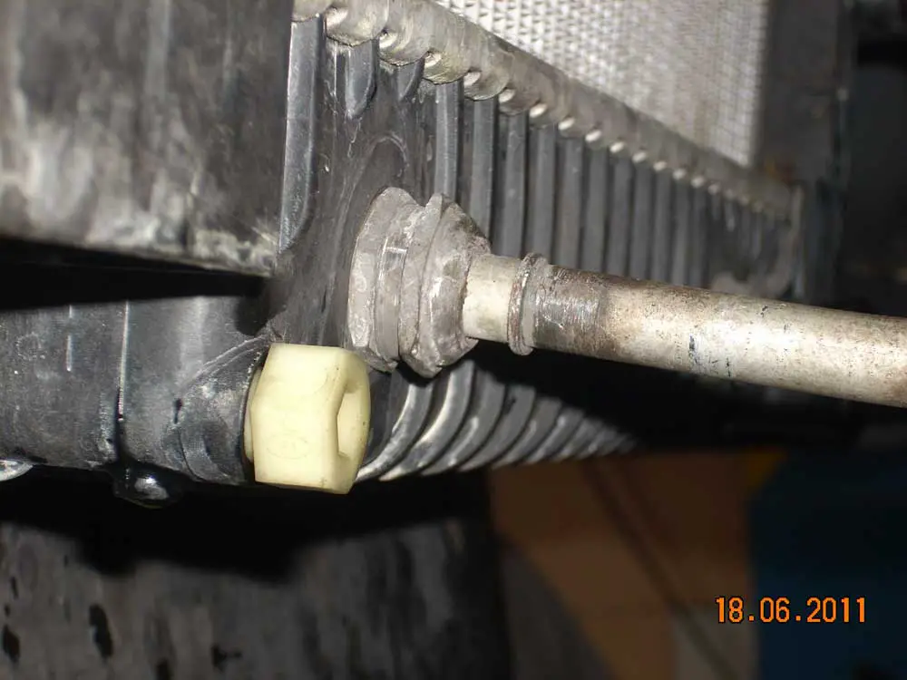

Vehicle Specs
Got my leaking radiator yesterday out of the car.
Special tool required for transmission cooler lines.
Leaking only at the drivers side.
Sticker shows different part number than the one on the radiator.
Lukas2009 is offline   Reply With Quote
