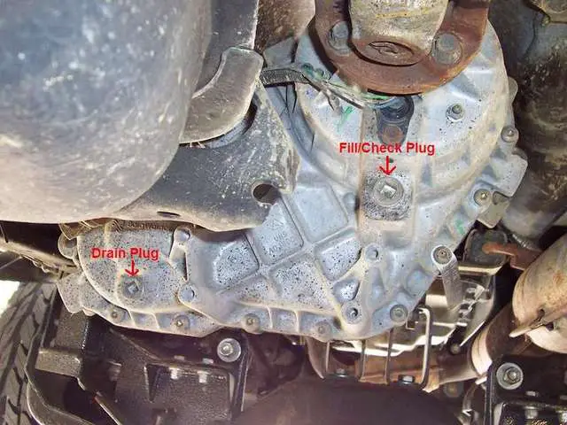

Drain the transfer case fluid. You don't have to drain all the fluid to change the seal, but you may as well change the fluid anyway, since you're there. I am going to borrow a pic from ExplorerDMB's thread here.
Step 4:
