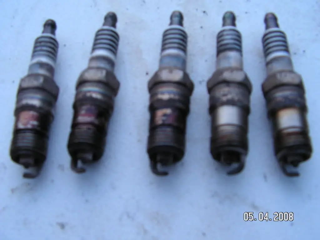

alright guys, I did it today. I bit the bullet and just said what the hell and replaced all 6 plugs and wires today in about 2 hours. The car is running much better now but I got a question. 4 of the plugs, all 3 on the drivers side and the back one closest to the firewall on the passenger side all had oil on the plugs. I don't think this is good, but what does it mean? The other 2 or dry. Thanks for the help everyone, especially you aldive

oh just i though i should add that the oil does not seem to be on the electrodes, but around the base of the metal instead. I can take pictures if anyone thinks it will help. Thanks.

Take a pic please.

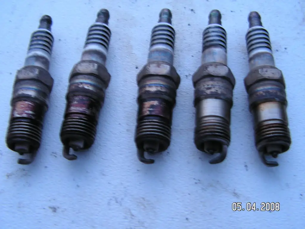

Hello, here are the pics i just took. The plugs don't look like any of the pictures on the site posted above. Thanks.
![]() ![]() The ones on the right are what the 4 oiled ones look like, the right two came from the passenger side 2 front cylindors. ![]() Thanks __________________ -Andrew 96 XLT 4.0 OHV-TT, AZ shackles, AR rims, 31x10.5 AT's, K&N intake, Borla exhaust, Pro Comp Pre runner, SnowSport Plow |

edit- left are the bad ones if you didn't notice lol

Well, your electrodes look fine. So I think your rings are okay. And you haven't mentioned anything like pinging, or mysterious oil or coolant loss. So my first guess would be leaking valve cover gaskets, which is pretty common.
