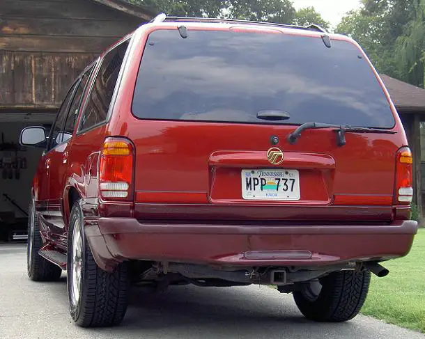

Look around at other Explorers and their tire sizes. Get an idea of what will look just right, or too wide, too narrow, too short etc.
This may help since mine are 18's also. These were my first 18's, 265/60/18, a 30.6" tire. There is plenty of room for a 275 in back. A 55 series tire would be an inch shorter than the 60 series. Each 10mm wider makes the tire 1/2" taller.

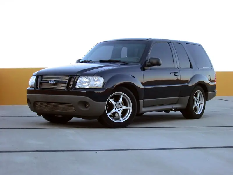

I like this one- He has 20's though
http://www.cardomain.com/ride/2511926
These look small on a 3rd Gen. 18x9's

And another from here- Members name is Slush Box. Not sure if he is around anymore.
I will see if I can find out what size rims/tires he has.
Edit-They are 18x9 Steeda Ultra lites with 255-55-18's.

I like that last sport. The look is great with that tire size. I was lowered 2" but now it's 1" so I'll be a bit higher than that truck. I think the 2" drop was a little much for; fitting a 3" tailpipe out the rear; and keeping the bump stops from hitting the axle. The ride was a little bumpy as well but that's probably because of the stock length shocks I was running at the time.
