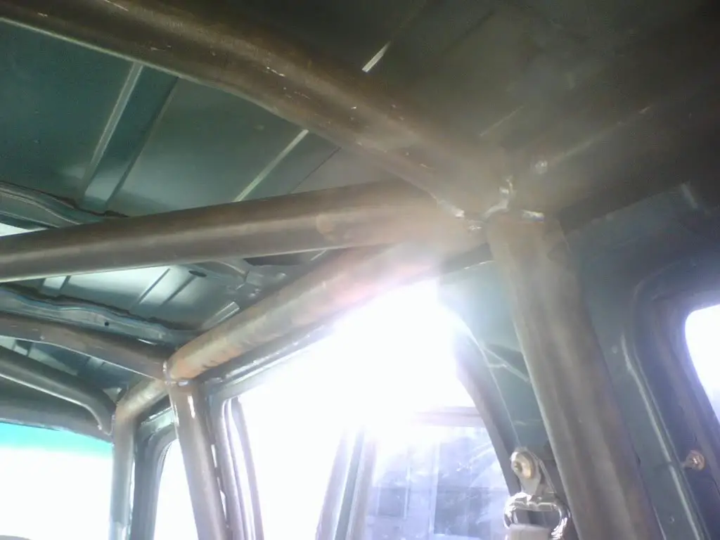

all the main tubes are to the frame already. so just break the tack welds and the cage should drop to be 360 welded. if not then we will cut holes in the roof to weld up and just repair what we cut.

we cut ours in the center of A,B,C dropped the top half welded the top of the cage, and put it back up, sleaved the tube with the next size down and welded bungs into drilled holes in top and bottom that we had made earlier.

not a bad idea. most of it is 360 welded and the parts that arent will get welded from the roof it looks like. should be all done tommorow. what a project this turned out to be, but i think its looks badass for sure.

I cut through the floor, dropped the a-b-c down as far as i could, and burned it in with heat blankets all over the place. FWIW i still got spark burns in various spots, but i did mine ghetto style with the interior still in. Also, there were a couple of super tight spots that i had to swap the welder back over to FCAW and take the nozzle off just to get to it.
![]() I think its kindofa PITA no matter how you go about it. |

pretty much finished. just some plating to do on the floors and roof...

Looks great! What was done behind the rear seats? Did you build onto the bedcage that you already had or did you start over? I ask because in the previous batch of pics it was not there.

it got cut out because it was only 1 3/4 and the cage is all 2". we got it out intact though so i can sell it.

Looks good, thats no doubt as tight as you're ever going to be able to fit one in an X.

Looks great Sean, nice and sturdy looking. Can you get a shot or 2 of the A-pillars going into the dash? Thanks

yeah ill get some pics in the morning, but they dont really go into the dash just t ucked right along side of it in the door jam area,
