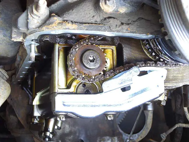

Count how many points there are on the bolt. If its 12, then its a 12 pt metric. If there are 6, then its an External Torx metric:
"External Torx" and sockets are labeled with an "E" followed by a number. The number represents the millimeters size.
If it is indeed an external torx, just get a set and you should be good to go. It may be a bit expensive but well worth it because both External Torx and regular Torx are used all over the engine internals. For example, on the SOHC engine, the tensioners are held on by an External Torx and the balancer's gear is held on by a regular Torx (image below). And dont try to put a regular 6-pt or even a 12-pt socket on the External Torx, there is a big chance it will slip right off and round off the teeth.
If you cant afford an entire set, you can use a regular metric socket to find the metric size (the number that goes after the "E") -- the right size will be tight by hand but dont turn it with a ratchet or else, like I said, you'll probably round off the teeth.
