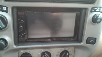

Kenwood DNX-5120.

foxsomeone
The Desert, Ca
2004 Explorer Sport Trac
Join Date: Jun 2008
Posts: 41
Vehicle Specs
Dang that looks really good!
What kind of din kit did you use?

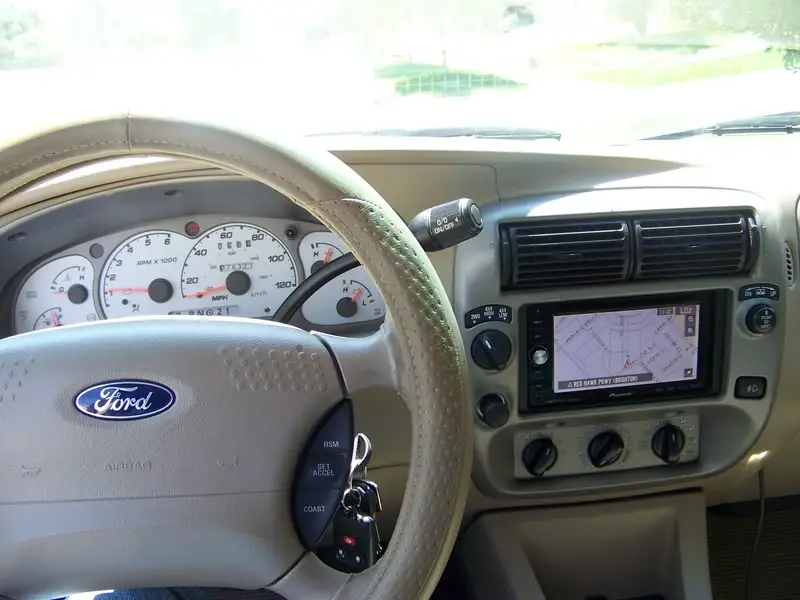

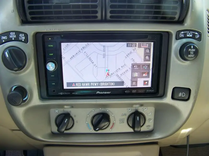

heres mine, Pioneer AVIC-D3

Did you guys just pull the old HU out and put the new one in or did you have to use a Din kit to make it fit or what?

Quote:
Originally Posted by foxsomeone View Post
Well I am just wondering whether they use din kits or just mount them in the stock din? cuz i want a screen like that but i dont know if ill need the kit or not ya know
yes, I used a din kit. i had to trim about 1/4" off the factory stereo bezel, but other than that its not too bad of an install. although you do have to tie into the vehicles VSS, which kinda sucks. but overall, I couldnt be happier with it. the navigation is amazing, as is the DVD player, the sattellite radio, the bluetooth, and the backup camera. it was pricey, especially with all the extras, but wellll worth it.
03sportrac is offline   Reply With Quote

Do the stereo controls in the rear seat still work with the AVIC?

Sorry for the delay. I forgot I posted here.
I used a Scosche kit for the side mounts and filler plate and a Metra kit for the rear bracket that attaches to the stock metal track at the bottom.
I sanded and painted the filler plate to match the stock bezel. In addition, I lined the back-side of the bezel with black felt to prevent any light escape/tiny gaps.
It's all about taking your time.
As for BT--no idea. I only have iPod controls going into the rear. My BlackBerry is not supported by the unit's BT interface, so I never added it.
