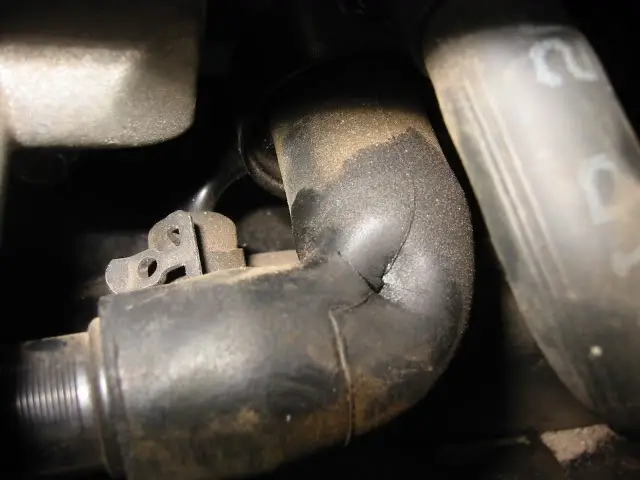

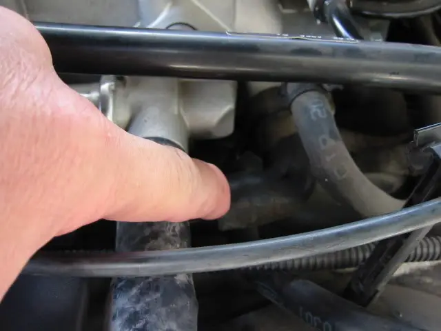

I found the solution to my rough idle problem. I thought I'd give this update in hopes of helping some of the many people who have tinkered with their MAF sensor or IAC without a fix.

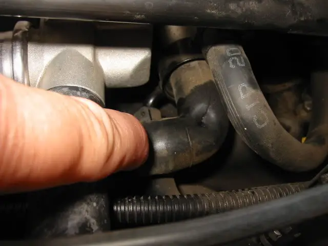

I took the noise insulation cover over the throttle body off again and went back for a second look. As I previously posted, I was going to go back and take a serious look at vaccum line problems. It turns out there was a VERY obvious vacuum hose problem. Specifically, the vacuum tube that runs from the PCV valve on the passenger side valve cover over to the throttle body air intake. The vacuum tube attaches to the throttle body air intake with a rubber elbow fitting. As you can see from the attached photos there is obviously a problem. The rubber is deteriorated at the bend and the significant vacuum causes it to collapse. There is a significant sucking sound coming from this point with the engine running. I never noticed that before because I never started the engine with the insulated decorative engine cover off. With the engine running I put my finger over the gapping hole and, viola, the engine idle returned to normal idle.
The elbow appears to be a Ford part so I'll go pick one up at the local Ford dealer tommorow. For now, I wrapped some electrical tape around the hole. After the fix I'll drive around a bit and see if any CEL codes are logged but hopefully I'm good to go.
Hope this helps some of you out. And, as other have said here before, check and re-check those vacuum lines!
In the photo below I'm pointing to the bad rubber fitting. Note above my finger, the silvery aluminum thing is the IAC on my 2002 4.6L V-8.
The next photo is a closeup of the problem.

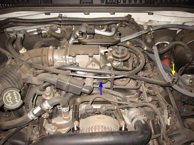

If your engine/vehicle is configured like mine then the following picture will help you locate the aforementioned rubber elbow fitting. The blue arrow is pointing to it.

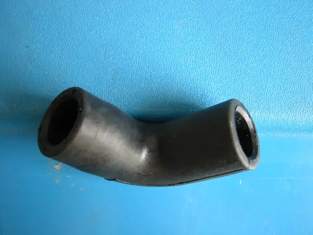

I had a hell of a time trying to locate just a replacement rubber elbow. I did a little research on the web concerning rubber elbows used on vaccum systems on Ford products. I discovered this is a very common problem not just in Explorers but all Ford autos using the rubber elbows. I don't know why you can not buy just the rubber elbow from Ford. They make you buy the entire assembly that uses the rubber elbow.
I went to my local Ford dealer's parts department thinking that if I have to buy the whole assembly then I'll just do it and consider myself lucky since I was able to self diagnose and repair my rough idle problem so easily. The parts department punched in on their computer parts inventory system the year, model, engine type and even the VIN number to pull up a diagram of my engine's emission control system with parts diagram. It looks like this:
They ordered the assembly labelled 6C324 insisting that this was what I needed and pointed out that the drawing even shows the rubber elbow plugging into the throttle body. When the part arrived it was ridiculously obvious that that assemble was not correct. Thinking it must be the other assembly in the picture labelled 6A664 they ordered that one. When the second assembly arrived it was also obvious that it would not fit my engine. They were baffled and said they didn't have a clue as to why neither assembly would fit. In the end they suggested I go to a junk yard and retreive a rubber elbow off a junked Explorer.

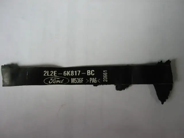

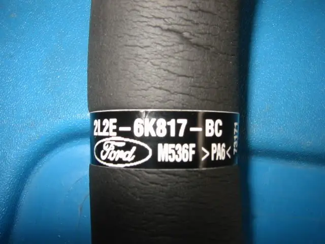

Confident he was easily going to figure out this mystery he plugged in the engineering ID into his computer only to find that this number doesn't exist for a 2002 Explorer. In fact, for some reason he was unable to locate the actual part number for this assembly. A crossed referenced part number to the engineering ID would have allowed him to get a list from the computer of all the cars that use the assembly. In the end, on a whim, he walked back to the parts bins that contained a hodge-podge collection of emission control vacuum assemblies and started looking for one that matched my original. By some stroke of luck he actually found an assembly matching that of the one on my engine.

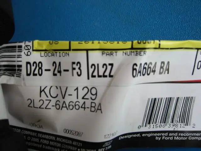

Finally, not only did we have what I needed but we also had the part number of the assembly. The parts guy punched the identified part number in the computer to find out what cars used this assembly. To our amazement this is what was displayed:

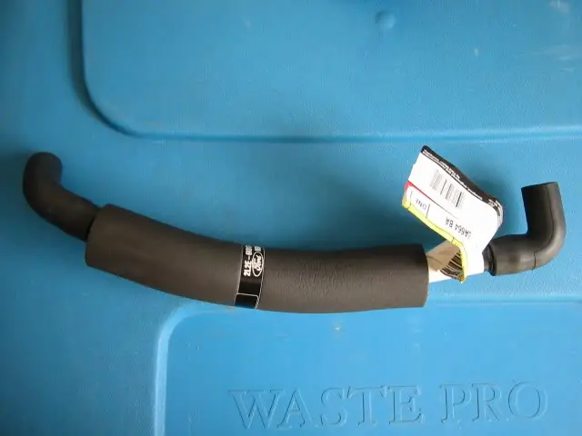

If any of you have a 2002, 2003, or 2004 Explorer or Mountaineer with a 4.6L V-8 and are having the same issue with replacing the PCV vacuum tube assembly and it looks like mine you'll want to have your dealer to order:
Part Number 2L2Z 6A664 BA
Motorcraft KCV-129
Engineering ID Number 2L2E 6K817-BC
In the end I'm glad I replaced the entire assembly. The rubber fitting that plugs onto the PCV value on the other side of the tube was starting to deteriorate too. Because of my troubles, the parts guy at the second Ford dealership sold me the vacuum tube assembly for $16.17 instead of charging me the normal $28.76 price. He also sold me a Motocraft PCV valve for $9.05 instead of charging me the normal $16.09 price. I figured that with 91K miles I might as well change the PCV valve while changing out the vacuum tube assembly.
