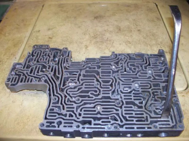

Sometimes the end plugs on a valve body get stuck, and there isn't much surface area behind them to pry them out. The spools behind them are also in the way, and could get damaged or stuck if you tamper too much with the end plugs. The bore sleeves could easily get scratched with picks, and add to the problem of getting both the end plug, and spools out. Picks break with excessive force. Here is a method of getting those stuck end plugs out. These pictures show the A4LD valve body. You start with placing a protective tool behind the end cap, and the spool. I have a drum brake adjusting tool in this picture.
The next step is to fasten it to a drill press vise (caution: don't make it too tight). You could use an ordinary drill, and a vise if you don't have special tools like these.
