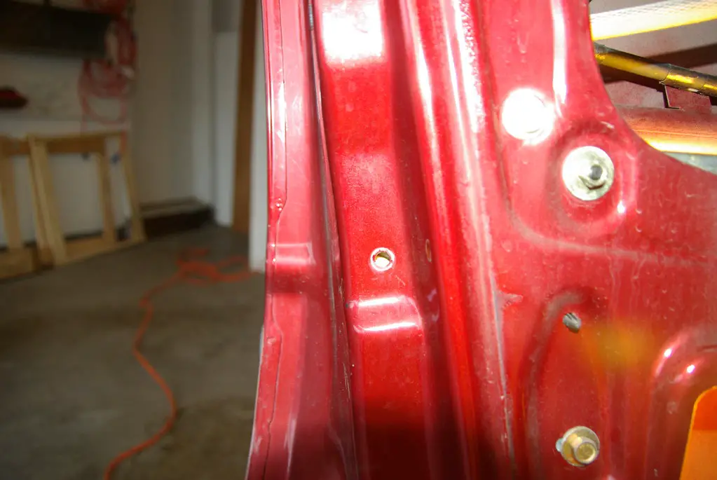

Here is how I fixed my driver side door locking problem
I had this problem for months on my driver side door. I couldn't lock it using the lock switch (Both on the door and on the back) nor using the remote. I feel that it tries to lock but the stick never goes down. I had to push it down manually. However the unlock works fine from the switch and from the remote.
First I excluded the wire issue discussed in this thread. becbause I feel the movement of the stick for trying to lock.
Last night, finally I got some time to diagnose it and here is what I found.
The actuator that moves the stick up and down for unlocking and locking was forced away from its position due to the missing of the holder on the door panel. So it is lower than its normal position inside the door. When trying to lock, it didn't have enough pulling force to ull the stick down. However it still can push the stick up for unlocking when he stick was pushed down.
Here is the picture shows that the holding ribber is gone from the driver side door.
Here is what is supposed to be. Picture taken from passenger side door.
Below if the how I fixed it.
1. Take off the door panel and took out the actuator.
2. Punch out the scew in the middle of the bracket.
3. Put a slightly longer screw in and towards outside so you can lock it with a nut later
4. Put the braket back to the actuator. This took me sometime because the braket is so tight.
5. Install the actuator in its original position and lock it from the door panel with a nut.

thanks for the pic
