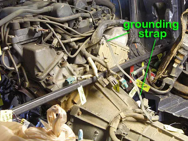

Engine grounding strap on the SOHC, not sure if its the same for the OHV.
But on mine, its attached to a bolt at the top corner of the passenger-side head and the other side (which is not attached in the image below) should be bolted to the front of the firewall.

yep... looked at my 96, the strap is bolts just beside the wiper motor (top center of the firewall)... can't see where the other end goes but the previous post is probably good. Having said that, I doubt that you will be able to get at it with "convolusions of snake arms"... :-)
IZ, it's nice to have your truck in such a state of dis-assembly! I've been following the build up! But that pic helps a lot. I think my other end attaches to a little hole on a bracket on the intake tho. I'm sure any solid ground point on the engine would be fine, just need to make sure it's easy enough to get to!
