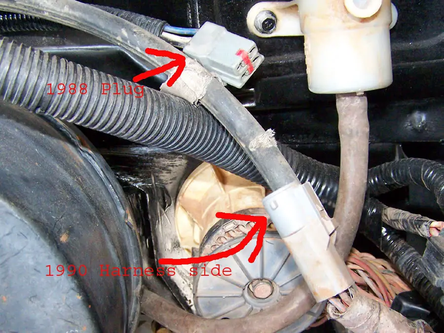

Vacuum line part of the heater fan harness. Can't see what it went to. I am an IDIOT!
I'm thinking this goes to the MAP sensor, which was in a little different spot between cabs. And naturally, I can't find the MAP and its bracket...
I'm hoping the wiring is the same, just need to find proper end. I can't grab from the 90 cab as it is long since gone, but I think I still have the 88 harness to hack from...

in the second picture the vacuum line goes to the air filter box. what would you like pics of? i have a 89 2.3, im just getting it running so i havent had a whole lot of time under the hood exploring but i'll try to help
First pic... That line has a section of hose to go to the intake manifold. I found it yesterday clearing things on the garage for my local club BBQ I had. I know where it goes and will get it there.
Second pic... Yup goes to the airbox. Figured that out when I put the airbox in and plugged in the MAF.
Third pic was just to illustrate that the connectors are different from 88-90. I cut off the connector from the 88 harness under my bench and will splice it into the 90 harness so I have working wipers. I wish I'd grabbed the wiper motor from the 90 cab before it was given away.

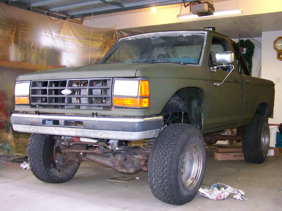

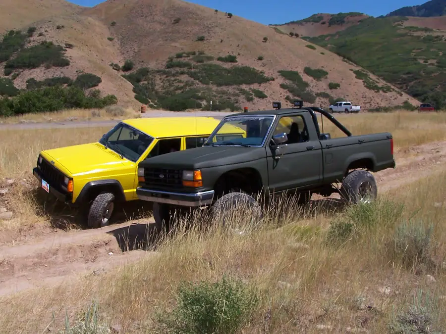

Figured a pic wouldn't hurt... Next project is a Jeep D30 for the front.
You'll notice little to no flex in the front... Need some softer springs when I swap in the D30 and radius arm links... Overall, the project took most of a year. I can explain more if anyone is interested...

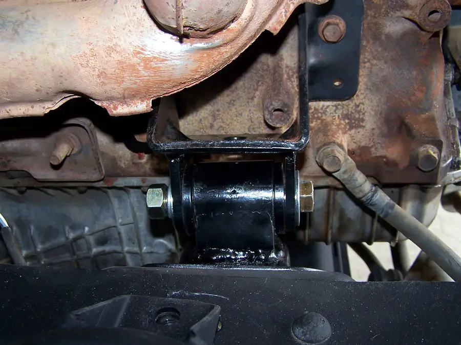

We decided to build new motor mounts since the stockers failed again...
These ought to last better and keep the motor from flopping if they do fail...

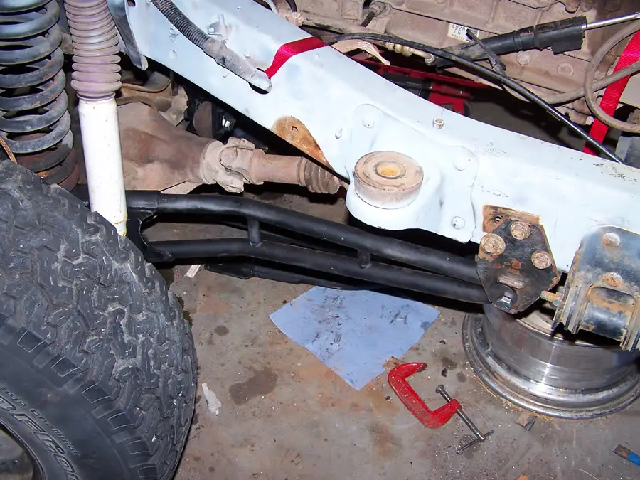

And we replaced the older style Skyjacker 6" brackets for Tuff Country brackets and extended radius arms. You see, one thing leads to another...

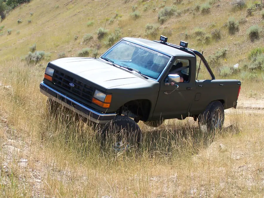

Got the cab on, the motor in, seat brackets fabbed for poly bucket seats, added a rollbar looking lightbar in the bed and a prerunner style lightbar for the front, and of course lights for them. Hmmm, longer front shocks, longer front brake lines. What else, oh, new clutch parts, throwout bearing and pilot bearing, new brake pads and rear brake shoes and cylinders. Hell I think we touched about every single bolt in this thing... And I still need to fab bumpers front and rear, a spare tire mount for two spares and a Hilift jack mount too. And paint the rest of the frame...
