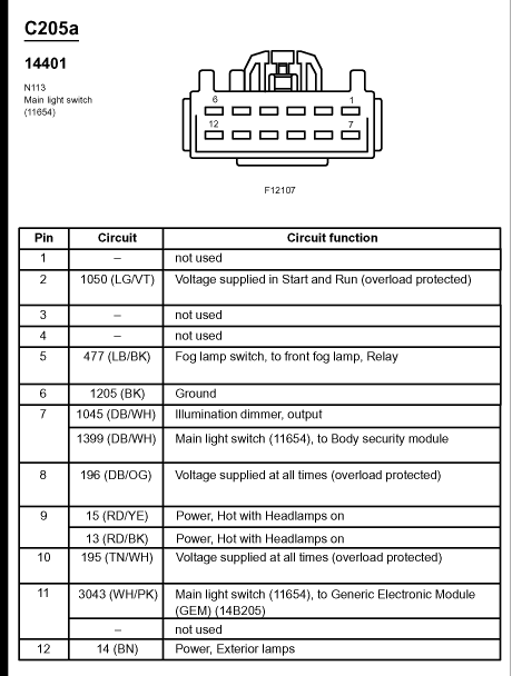

Here is some additional info.....
switch diagram...I only see one...there not a diagram for early and late build. In My GF's the wires are in the opposite order. 1 is where the 6 is.....like you'd think it should be...1 starting on the left.
Can anybody check to see if their's is the same way? and this image is just wrong.....

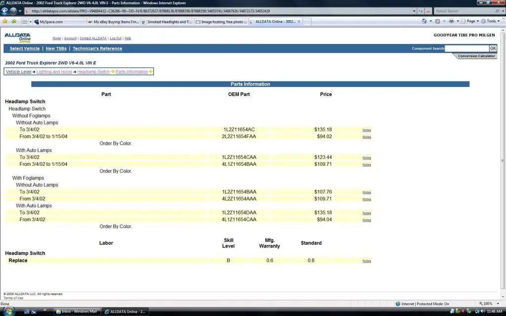

And heres a list of all the switches......
