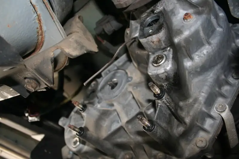

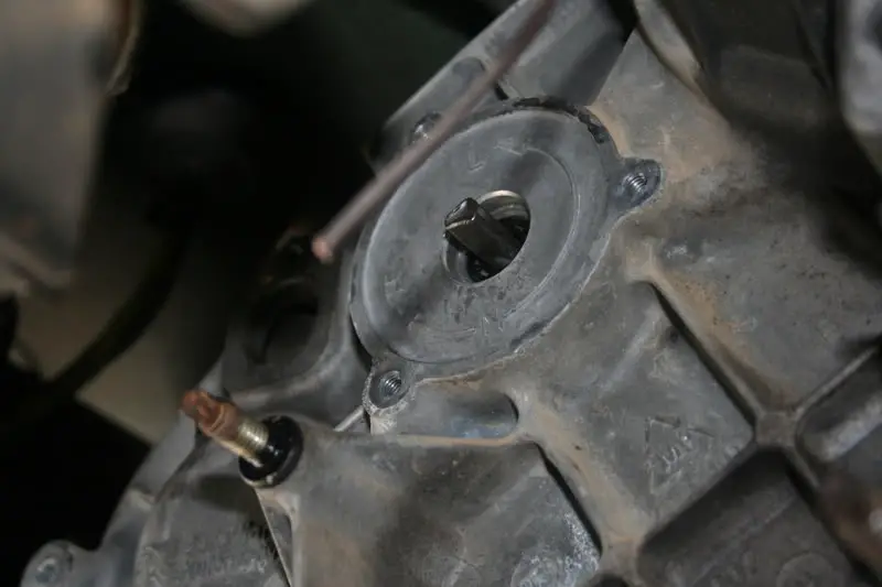

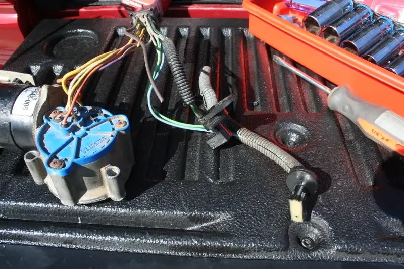

Fixed!!!
Okay so I found the parts on rockauto.com. I took pictures on the exact part numbers. I took the old sensors out, removed shift motor (you can see they the 4WDH is engaged), cut the brown wire, replaced the sensors in the connector, reconnected the "brown wire", put everything back together. First thing I did was start it and put it in 4wdh, then 4wd low, then back to AUTO. Then took it for a ride around the block. I no longer had any binding issues, and the lights did not come on, at least for the ride around the block. So I took it to the muddy back yard to get it stuck. When I could no longer move, I poked my head out and seen the front tires turning (this is with selector lever in AUTO) No 4x4 Auto indicator light came on (I'm not sure if it is supposed to). So, I backed it up, pulled it back onto the road to see if there was any binding. None. Awesome, problem solved.
