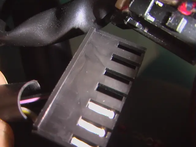

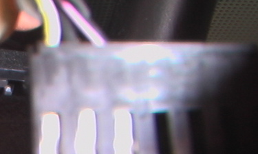

My auto dim mirror has stopped working so I thought and it was a bad connection. However, when I pulled the plug out the wires (3 wires, grey, black, black/white stripe) fell out of the plug. The problem is that their are least 9 possible pins that they could fit into. I think they were grouped together on one side of the mirror but, I don't know in what order they were. Can someone please take a look and tell me what goes where?
Thx,
Is this the right angle?
Toughies :) Does this help?
Thx again, you made my day. I had the wires in the right order but on the wrong side of the plug. What the hell oare all those extra pins for anyways?
I think it's the order... Ford can make things so complex. I didn't even know that big plug was there...
