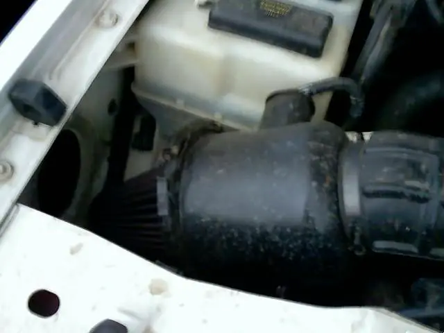

ok here is the intake
http://sponsorship.loopd.com/Applica...060db%22%7D%7D
http://sponsorship.loopd.com/Applica...25dd8%22%7D%7D

ok charlie how does this work?
http://s431.photobucket.com/albums/q...=Photo0315.jpg
http://s431.photobucket.com/albums/q...=Photo0314.jpg

Photos work fine now, thanks
Hope it wasn't too much trouble...I had been curious how it looked, and what all you had done. Thanks!

I have a somewhat similar setup, it's the stock intake, with a K&N filter, silencer removed. From what I see, it appears to be very similar to what you did, just without using an adapter.

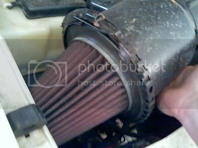

how did you mount the intake cone without the adapter? it may be your turn for the pictures
burtonbrd138 is offline   Reply With Quote
Old 08-29-2008, 05:00 PM   #14
Charlie
Wisconsin
1995 F-150
Join Date: Aug 2006
Posts: 4,487
Vehicle Specs
Sure thing..be right back with pictures and edit the link into this post.
Pictures...(after all, I can't ask somebody to take a picture of something if I wouldn't be willing to do the same)
Don't mind the mud and whatnot that got sprayed up in the engine bay..it's a little dirty now, and these are camera phone pics, so please bear with the photos..
With the stock clamp that was there, I was able to catch the lip of the filter so it holds fine. I thought about trying to do something else to get better flow, but haven't bothered as of yet.
