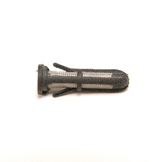

Okay I decided to start early. I have a couple questions. First, I don't see the small filter that is supposed to be in the seperator plate on my vb. Does anybody know if I could have lost it when I removed the vb from the explorer or if it is held in place by the seperator plate screws. Where can I get another one of these, and what is the part number? Second there appears to be a spring on the upper portion of the transmission that the vb bolts to. It is located near where the solenoids are. I have a picture, but don't know how to make that appear here. I assume it belongs there and should stay.
Zed is offline   Reply With Quote
Old 11-07-2008, 01:25 PM   #17
BrooklynBay
Aerostar Forum Moderator
Brooklyn, NY
BrooklynBay's Avatar
88 89 93 95 96 Aerostars
Join Date: Nov 2005
Posts: 45,813
Vehicle Specs
WWW.TransmissionPartsUSA.Com has those small sock style TCC snap in filters. Here's a link: http://www.transmissionpartsusa.com/...-00023330a.htm
BrooklynBay is online now   Reply With Quote
