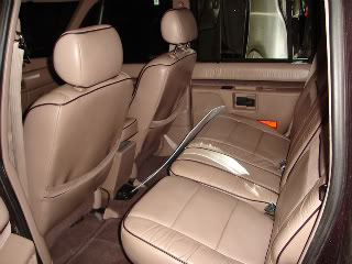

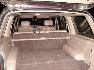

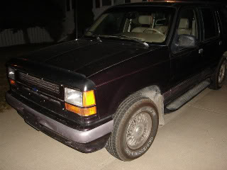

Hello all. Just bought my first Explorer today, a very nice 93 Limited. The wife and I were looking for a second vehicle, something a little bigger than our Kia for camping and what not. Found this on our local classified web site.
The interior is mint on this thing! The rear seats look to have never been sat in and everything is solid as hell with no squeaks or rattles going down a gravel road. The doors still shut with a satisfying thud and the carpets are as clean as the day it rolled off the assembly line!

These are the pics I took last night before the previous owners vaccumed the interior a bit. Low mileage for a 93, 160,000 kilometers (not sure what that is in miles!). More pics to come!
