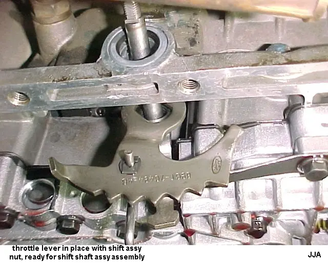

Once the shifter shaft seal and the shifter shaft assembly are in place, it is nearly impossible to remove the shifter shaft assembly without ruining the shifter shaft seal - the sharp corners of the groove in the shifter shaft shear off the sealing lips of the seal. I learned the hard way.
The throttle shaft assembly seal was an o-ring and it was replaced with a new o-ring OEM p/n 386078S.
To remove the shifter shaft assembly and throttle shaft assembly, it is necessary to remove the shaft nut holding these two shaft assemblies in place. It was necessary to remove the external neutral safety switch (NSS) before re-assembly as the inner detent lever bears against the inner pin of the NSS, to complete the inner re-assembly.
