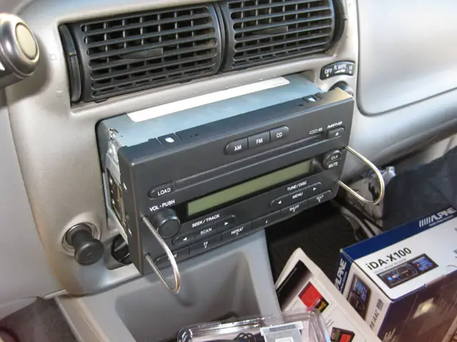

Glad you figured it out. Here is a pic from my install to help you as well.

yeah i had my local shop take mine out real quick. hes a cool guy. mines just sittin in there til i can go ahead and replace mine with the aftermarket.
