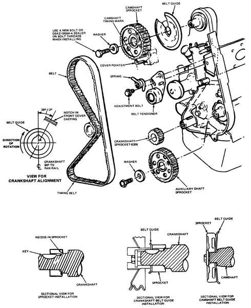

hey svo do u have a pic of the cam timing marks......where it shows tdc

svo where did u find that at

I'm a twisted warped 2.3 turbo kind of guy!

Does anyone have?
A diagram for timing marks for a 2.3L 1993 single Cam ford ranger

...The diagrahm's in post #12 of this thread should work for you...
