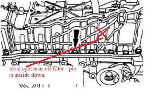

Please see the below excerpt about these engines (upside down view)... Do you think that there is enough meat to cut and tap a drain plug? To even get this tapped, I think I will have to drop it from the truck. I was looking under the truck the other day (hiding quietly from my girlfriend) the surface is filled with thickened girders/webs to reduce vibration and increase its stiffness/strength... not a flat surface in sight...
Has anyone dropped this skirted aluminum oil pan, this pan-above-the-pan.
It looks to me like I would have to remove the flywheel cover... and I guess that means I have to remove the starter?... maybe even an engine mount to slide it out...
Has anyone ever removed this part here?

From what I recall from a previous discussion, that's best done with the engine out... But I could be thinking of another vehicle.

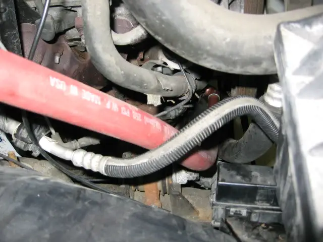

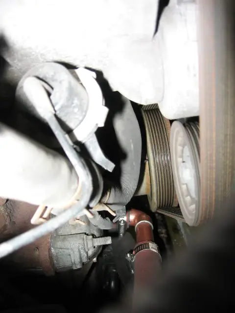

Cobraguy, as shown in the picture below, there isn't enough space to put the return bung anywhere, eespecially such that there is at least 1" clearance above the top of the oil level.
I will be spending the day tomorrow just on this objective, so any advice/help from others on this forum would be greatly appreciated. I've looked at the other 4.0 setups and none have done this - to my knowledge. I think Amac told me he drained it through his own tapping on the timing cover near the drivers side front (I see a flat spot there)... but that seems to involve removing the fan and rad for access.
I will post pics of myself crying if I can't figure this out!
I really did give it a good look last time, and couldn't figure out where the best spot would be.
Maybe, i can find a place to tap and bolt through a threaded/barbed hose fitting in the ALUMINUM skirted area above the pan, that is, after I verify that the oil level is at least below this point (hopefully i will see the dipstick here and can work backwards from that.) I wonder how much the oil level changes when the truck is running compared to when its off.
This is all part of another remote turbo setup... I've been keeping it quiet since I don't want to post my progress until I have more done... by my photobucket (http://s396.photobucket.com/albums/pp47/johnnybee23/) can show you some of my piping (and ideas/pics I took from others) and wideband stuff... I will eventually prepare a nicer writeup for anyone of interest (plus to ask questions when I get stuck)... I don't want to fill the forum up with my useless gibberish... at least until I've got more done.

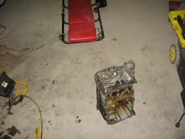

I'm sooo disappointed today. The bottom black steel pan took only 5 mins to remove. The upper pan (aka ladder frame) won't come out... Researching this, ... sources online confirm that at least the front axle has to drop and engine must be detached from mounts and lifted 1.5"/or drivers side header removed.
So, I've literally spent 5 hours looking up the skirt of my truck (perverted?), scratching my head trying to find a place that has both clearance for tapping/drilling and is 1" above the high oil level indicator on the nearby dipstick end. Its torture since there are a few good spots, but they are blocked by - the oil filter, or the transmission lines, the starter... etc and even with my two different angle drills, clearance isn't sufficient.
When I get around to pulling the motor, (I never ever wanted or dreamed of doing that), (to send out for the timing chains/cassettes/tensioners rattle fix) I can pull the upper oil pan out and hug it and tap into it then.
The side on the starter has the biggest free area, but for my setup, I really want the return line at the passenger side, in the small space between the oil filter and the oil pan, on a 45 deg angle. I'll use a 45 deg bulkhead fitting with rubber or copper gaskets on inside/outside. See my image:
Honestly, at this point, I am probably going to get a sump tank and shur-flo pump. This little hitch is costing so much time. Damn it, I was really hoping to avoid a pump setup.
There must be another way to tackle this. I don't entirely believe that the front cam timing cover is not an area of pressurized oil (and therefore a good place for a turbo's oil return). Can anyone help me with this concept?

More progress made.
Yes, I should really talk to James, he has done some amazing things with his truck. So far, I have not decided on what to do with tuning.
My truck is in pieces, and I really should make the call on tuning now, so that I can put my 42#'s in and get this over with in one shot.
I was planning on running very very low/no boost but still use the stock injectors and all the piping through the turbo, until I could get it to a tuner - then throw in the injectors, a tune, and an 8 psi spring on wastegate.
For now, you can see two days of nasty work - to get the upper oil pan off and drill and bolt through a bulkhead fitting. Oh my god, this was hard. I had to remove/loosen left side exh header, starter, left side catalytic, front diff., etc. Then, by myself I jacked up the engine with prybars and pieces of wood on small jackstands (not fun). I still have all ten fingers, and half a brain.
The hose is silicone multi-ply and rated for 250 psi, high heat, and suction.
here is the place I drilled through the oil pan. It was precisely guesstimated and worked out perfectly. It is just below the crank on the pass side.

Very good Johnny, you did it and avoided having to add an external oil pump. I'm going to tap the steel pan for a return for an extra oil filter. The pictures here helped me to select the flat bottom next to the drain plug.
I'm about to drill two holes in my V8 pan of my new engine. It's not in yet, and adding the holes and fitting now is easy compared to later.
