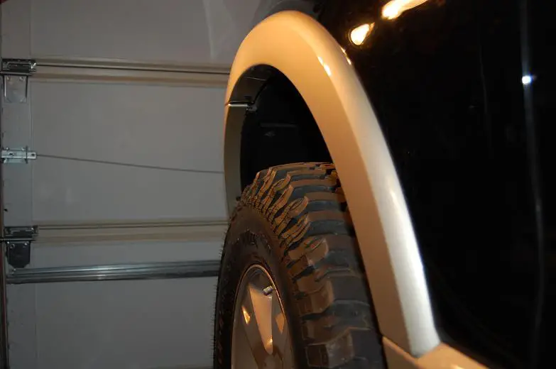

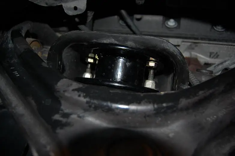

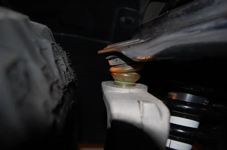

NEW Pics
No full truck pics yet... but, the lifted height (wheel opening) on front end. Rancho RSX shocks. RoadBully 2" Powdercoated Spacer. The last pic shows the angle (after installation) of the upper ball joint. Some people wanted to see the angle on 2" spacers.

In the above pictures you'll notice a couple things - First, with the 2" RB spacer, there is plenty of room between the wheel spindle and the coil spring. With the wheel spacers (I'm running 30mm Eibachs)- there's room for a wider tire (at least a 275/70R17... possibly a 285). And last but not least, the angle on the upper ball joints is not that bad compared to a 3" RB lift.
There is plenty of space from the spindle there... that's my main concern...
