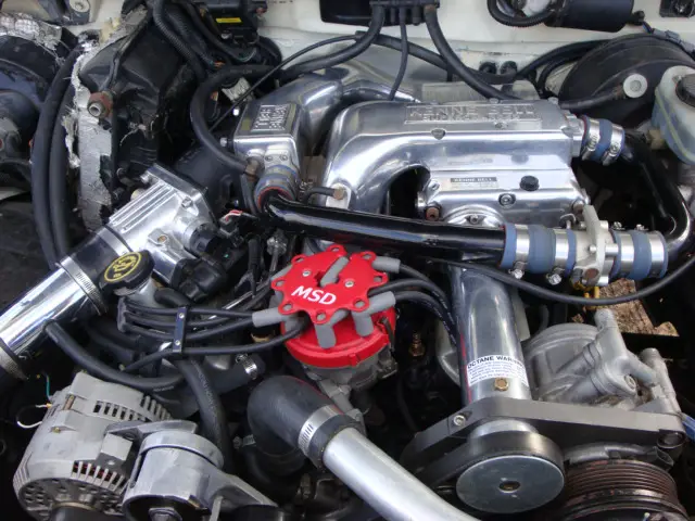

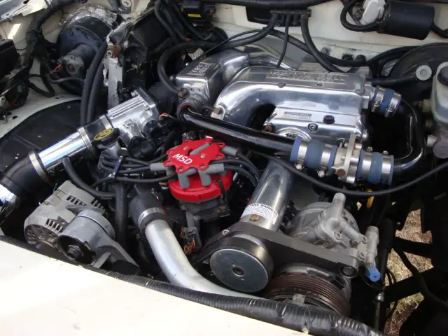

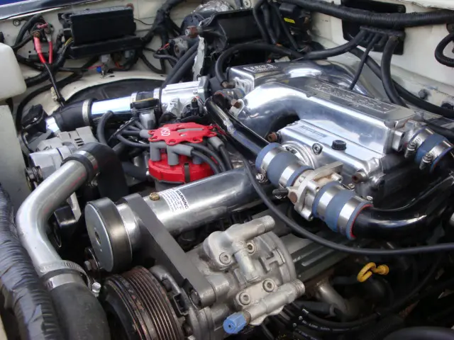

Ok, So I pole-smoked this one and didnt get any pics of the installation.... But here it is.
- 91 mustang 5.0L stock longblock for now.
- 2.2 Kenne Bell Polished with bypass. (6psi for now)
- 36lb Ford blue top injectors.
- 77mm pro flow MAF sensor.
- 80mm Ford racing Throttle body (94-95 style)
- 255 lph walbro fuel pump.
- K&N Large Filter custom cold air set-up.
- Autolite 3924 plugs.. 1 heat range colder than stock. gapped .035
- MSD 6AL with 6000 rpm pill
- MSD Blaster TFI Coil (mustang specific)
- MSD 8.8mm Super Conductor wires.
- MSD cap and rotor.
-Tuned by me with a Tweecer R/T
-Custom Long tubes with 3" single exhaust.
-Single High flow cat
-Flowmaster series 50 Muffler. 3" in and out.
Here are a couple of pics...

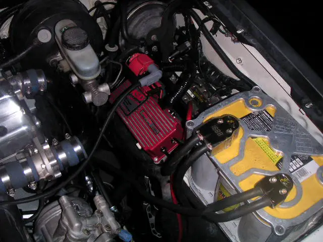

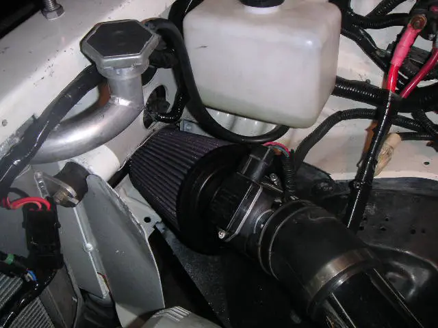

Here are a couple more of the engine compartment.

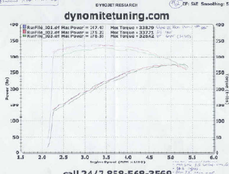

Here is the 1st dyno I got after the install... It was lean starting at 4200 Rpm and by 6000 it was way lean 13.6 AFR . Target is 11.4.
I have since fixed the lean issue But I have to get a new dyno run. Ill be getting it soon. I expect atleast 25-30 more HP and TQ?? Check out the torque curve of the kenne bell!!! got love it.
I plan on getting water/meth injection and bumping up the boost to
12ish psi... That should crank out pretty good.
Its not a very good picture but... The first run file was shut down way early, so disregard that one. Dont forget this is through 37" tires also...
The net increase was about 80RWHP and 80RWTQ...
You can pretty mush see right at 4200 rpm the torque starts diving and the hp starts to taper off. Thats because it was lean. I cant wait to get it back on the dyno!

Stock mustang 5.0 engines are dogs. They only come with 225 HP and thats at the crank not the rear wheels. The beauty of them however, is they are easy to get horsepower out of them. When my 5.0 was stock it only dynoed 196 HP through my drivetrain... It has alot left in it. These dyno numbers were also very lean 13.6:1 AFR. I should be able to get it back on the dyno soon and see better results now that it has been richened up. Also, water methanol, 12psi,and some more timing should be worth another 100 or so rear wheel hp.... The stock heads are Very restrictive ;)
It was running super duper lean with 6psi. Just getting the bugs worked out should make the numbers you are expecting.
Looking good Tim. A 4wd drive train and 37" tires eat a bunch of power. Swap some 31"s on there for a dyno run and I bet you would see the numbers go up.
