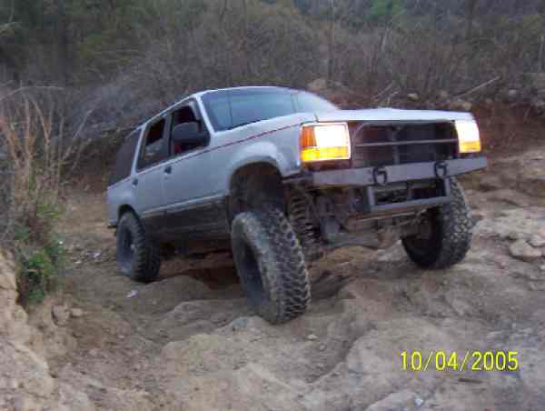

On a 92 Explorer, I'd do the following in steps:
1. Remove or make disconnects for the front sway bar. Cost = $5.00 for hardware hitch pins in 1/2" size. Drill out two holes and slip in the pins -- done. This allows much more travel in the front end.
2. Remove the rear sway bar. Cost = free. This allows for more rear travel and flex.
3. Remove the factory overload spring (the big flat one under the spring pack) on the rear springs and replace it with a generic full-length overload spring from Auto Zone or Pep Boys. Cost = $30.00 for the springs, $5.00 for new center pins. Soak the U-bolts with PB Lube, tap with a hammer to start the penetrating action, then loosen one side at a time. Remove the center pin on the leaves (they will then be loose -- have a friend to help). Stick a new center pin in, tighten the leaves together, then stick on the overload beneath them and tighten the U-bolts back down. This allows for more flex in the rear suspension.
4. Add longer rear shocks (4" lift shocks work good). Cost = price of shocks, from $25 to $100 (or free if you can find take-offs). You will need the extra length to make sure that the shocks are not your limit straps.
5. Add F250 front shock mounts to the front end in place of the stockers. Cost $30.00. Cut off the half of the spring perch that is the shock mount on the front suspension. You can do this with a cut-off wheel or torch (or even a hack saw or sawsall). Bolt on the new shock mount (watch for lines inside the frame rail). This mod allows for much longer front shocks that will give you about 15" of front axle travel.
6. F 350 Superduty front brake lines. Cost $50. This allows for maximum front travel without tearing lines. This MUST be done with the F250 shock mount mod.
7. Longer front shocks. Use the catalog and find 15" stroke two-eye shocks. Cost $25-$100 depending on shocks (or free take-offs). This allows for maximum front end travel.
8. Longer shackles for the rear springs. Cost $15.00 if you make your own -- $50+ if you purchase. This allows for a bit of rear lift and more articulation. Make 2" longer than stock.
9. 1975-1979 F150 coil springs. Cost $20.00 (salvage yard find). These are softer and flex much better than factory springs. They will not give lift, but they will give travel. Add a coil spring seat from an F150. Cost $30.00 to gain an extra 1.5" of lift.
10. 3" body lift. Cost $100. This will allow you to move up to 33" tires with the above mods. Otherwise, you can run 31" tires and have more travel than most Jeeps and other 4x4s you will run with.
Other modifications include moving the air intake to the top of the hood to stop the problem in filling the factory air box with mud and water. Cost $30.00. Use eBay cheapy hood scoop, and RV flexible plastic hose. Also works as a power adder.
Bumpers/skid plates/sliders. Find some water pipe and a friend with a welder. Go nuts. Cost = materals -- typically almost free if you scrounge around.
Total cost to build a truck capable of doing 80% of the off-road trails in America? Under $500. Deliver a few pizzas and get building.
holy crap dude, thanks tones, that was alot of help, although could you give me some more clearification on step five in your list. i was wondering also if you could help me find that spring you are talking about and where to possible buy all the other parts, and also what year F-350 would you use for the break lines or doesnt it matter. sorry for all the extra questions i just want to get this right
The F250 shock mounts are sort of self-explanatory once you hold them in your hand. They bolt flat to the frame, and extent up into the fenderwell about 6" higher than the stock molded ones. When I've done that mod, I've cut the stock shock mount away from the upper spring bucket (look under the front wheel well and you'll see what I'm talking about), then stick the F250 mount right next to the spring bucket, drill the holes, and bolt it in place.
Here is a good link to the process. It will help to show what you have to do.
http://www.therangerstation.com/tech_library/F250shocktower.htm
For the brake lines, any late model Superduty will work. They all fit. They are about twice as long as the stock brake lines, and will allow for as much as 15" of travel. I used a couple of loose nylon wire ties to hold the brake lines in place so they wouldn't rub the tire or get between the spring (by loose, I mean make a BIG loop and just let the line ride in it).
One other step I forgot to mention... Capture the top of the coil springs to the upper spring mount. Use a small muffler clamp or some sort of J-hook that you make. I used the small clamps for simplicity sake. If you don't, once you to the other stuff, you can potentially loose the top of the spring from the upper mount, and it is a pain to get back in place on the trail. I learned this the hard way... ;)
If you do the mods above, this is about what you are capable of:
