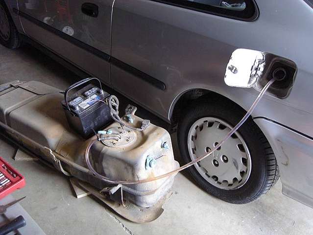

But if you're absolutely sure the fuel tank must be drained, you could remove the high pressure line and put it over a fuel-safe container while you turn the ignition on -- this will force the fuel pump to suck all the fuel out and into the container. My ghetto setup of draining the Explorer's fuel into the Civic before being discarded:

As for dropping a full tank, you dont really need to empty it to change the pump. Use a floor jack to lower it while some one stabalizes it. If you're going to disconnect the fill hose (and breather), as you saw in my pics, surgical gloves (blue in the pics) and some rubber bands work great to stop evaporation.

That battery near the tank makes me nervous. Hopefully it is sealed and there are no fumes. Lets make others understand this.
Also, any container that receives fuel should be approved for the job and sitting on the ground and not on anything else. This is to prevent any static electricity issues.
Safety first!
I was afraid too but after sealing off all the ports with parts of a glove and with a fan blowing from the back (mid-atlantic summer) towards the garage opening, I'm still kicking.
EDIT -- this might make you even more nervous: after the liquid fuel was evacuated, the tank was filled with water and sawed (reciprocating saw) in half
