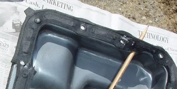

My goof
I checked the fluid flow at the input to the aux cooler and found flow. Hooked the lines up again and checked for flow at the output of the aux cooler: again no flow. Ah ha! Clogged aux cooler! Negative - red herring as you'll see later.
I hooked things back up and proceeded with my latest game plan. Finally got the second bolt off the catalytic converter's rear exhaust coupling and got that section removed. What a difference access makes! Clear view all around. Use my nifty new pan drain and cleanly drop the ATF into the catch pan. Uh oh, not nearly enough fluid comes out. About a quart. Uh oh. Where'd the rest of the fluid go?
Drop the pan and don't get a bath. Examine the pan gasket and find this:
Gasket torn through in one place and almost torn through in another place. Check out how badly I crushed that gasket! Rookie mistake - grossly over tightening the pan bolts. Sigh. The torn piece of the gasket was directly over the catalytic converter. Hmm. Remember this from my original post:
> Drop down and see the catalytic converter smoking pretty good - ok that makes sense, I dropped alot of oil on it getting the pan out. So maybe it just needs time to burn it off. So far so good.
Negative. Add this to the catalog of mistakes I've made so far.
Both BLee1099 and eXcali got this right - they called low fluid levels as the cause of my failed shifts following my fluid change. I suspect all the stuff about the flow into and out of the aux cooler is misleading: there was probably just enough standing fluid in the bottom of the pan to get the flow started into the aux cooler, but not enough to fill it and result in output.
Closely examine the inside of the pan, it all looks good - just as clean as after my pan drop and filter change last week. I'm reassured by not finding chunks of metal, but it's too soon to celebrate.
Pull off the filter - O rings look good. Compare the filter I installed last week with the new one I've got ready for this time and they look about identical. I can't see any sign of major gunking in the used filter.
Peer up into the valve body and inspect closely. No sign of extra O rings in the filter connection ports. No sign of any damage to the valve body gasket. No sign of anything bad. In fact the whole thing looks remarkably clean. I do notice that there are a couple of hand written marks (looks like from a sharpie) on the side of the valve body. The upper mark is '2', right under it is 'X'. No idea what this means. Someone's been in here before? Is it possible to tell from looking at the valve body if the TSB has been applied? Or do you have to take it off the transmission and open it up to check?
Following advice I check and re-torque the 23 valve body bolts in accordance with the Ford instructions (somebody posted these on the 5R55E rebuild diary thread). I set my torque wrench for the middle of the spec range - all of the bolts tightened a little, probably 1/8th of a turn on average. That seemed about right to account for the age of the gasket and also possibly the original torque at the lower end of the range.
While I had the pan off I also followed another suggestion from another thread and applied RTV to the threads of my new drain valve just to minimize the chance of leaks.
Installed the new filter with new O rings. Reinstalled the pan and gasket finger tight - I'm now off looking for a torque spec for these bolts so I don't repeat my blunder. You experts have the right torque in your muscle memory, us rookies need to follow a spec!
I'm still wringing my hands.
First, does the torn gasket and the smoking catalytic converter really account for the lost ATF? I'm nervous about this. I'm supposed to believe my indications, and the solid indications I have are a torn gasket and smoke from the converter and too low an ATF level. But if this was really the problem, wouldn't I have seen it puking ATF in the driveway when I did my test drive? Is it possible to have taken the test drive, puking out the ATF and not noticed? Well, where else could the fluid have run off to?
Second, have I damaged anything? Can't really know until I refill it and try to test drive it again.
The new game plan:
1. Find a torque spec for the pan bolts.
2. Reinstall the catalytic converter (wow that O2 sensor connector is hard to reach).
3. Fire it up in the driveway, shifting through the gears, keeping a close watch on levels and looking closely for leaks.
4. If it passes #4 then try to drive it.
Let me know if you see a better plan!
