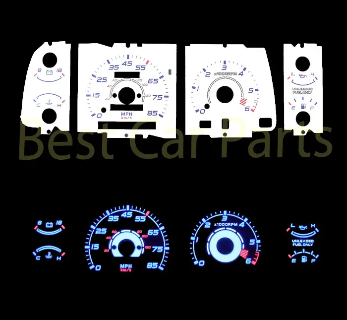

Gauges
I'm installing that set right now. here is a pic.
you will have to cut for the 3 screws on the tachometer, also that gauge has a hole for a needle perch that the factory gauge does not have so I need to find one to glue in to eliminate the hole.

There are no holes in the new gauge for those screws. If I don't poke holes for the screws I can not install the gauge.
See this is what I was talking about. If I don't poke holes then the gauge is useless anyway so it is worth the risk to me.
nevermind just noticed that you are talking about different gauges,i couldnt see them on my phone

After poking the holes in the gauge did it work? Have been sitting on these for awhile now because of this exact situation.
I have not done it yet because I'm rebuilding the front and rear axles with 4.56 gears and lockers. Another problem I have is the new gauges have a needle perch hole on the tachometer and my factory gauge does not have this perch so its just a hole. I complained to him but he ignored me. I will let you know what happens when I finish it.
those are the same
Posted via Mobile Device
they are different from the ones you've installed and the ones jlaudio is trying to install
my picture i got off ebay shows the same gauge, but one in daytime and one at night if that is what you mean
