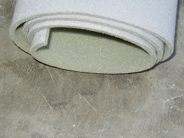

...This is what I purchased for my Ranger so verify quantities for your vehicle..
Material's
Medium Grey Headliner
The Headliner material I bought was sold in 50" length, and you buy it by the yard...Different supplier's will count yardage differently...My supplier counted my material as 3' width x 50" length = 1 yard - Cost = $13.50 pl. tx.

...You had also asked about how they shipping for these products.....I went to them direct and picked the stuff up...

Just received the material in the mail, they are quick to ship but after you give them your card info you never hear from them. Anyway, midnight blue on a tan leather EB, we'll see how it looks... EB nautica package. Anyway, I am tearing into it next week, I'll post pics when I'm done.
-Martin

...If I don't ask, someone else will...Why did you go with midnite blue on a tan interior???
...Do you have any pics of how the items were shipped to you??..It might be useful for others who want to order also..

I don't know, just wanted to mix it up a little bit.... we shall see what it looks like. As for the shipping, it came as a bolt on a cardboard tube wrapped in plastic.

Yeah, finished it up last weekend.... I had a fiberboard headliner, pulled off the old material and scraped it down lightly with a wire brush until I hit the old adhesive, couldn't remove that without damaging the fiberboard so I just glued on top of it. The install looks pretty darn good, I kinda like the color, I'll post a picture when I get home.

here we go
